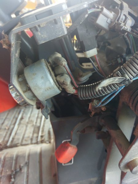

    Noticed something weird on tractor last week. I had initially chalked it up to low battery but think it's something else. Grand L series Kubota 3130 HST. When I cycled the key to glowplug heat, the digital screen flashed a bit and the heater did not kick on. I turned to crank position to see if battery was dead and the tractor rolled over and started (first time in a couple months) to my surprise. Went and did what needed doing and parked the tractor, not thinking of it afterwards. This past Saturday I went to fire it up and it did the same thing. This time, I noticed that if I jiggled the key a bit, the digital dash would flicker and the plug heater would come on.

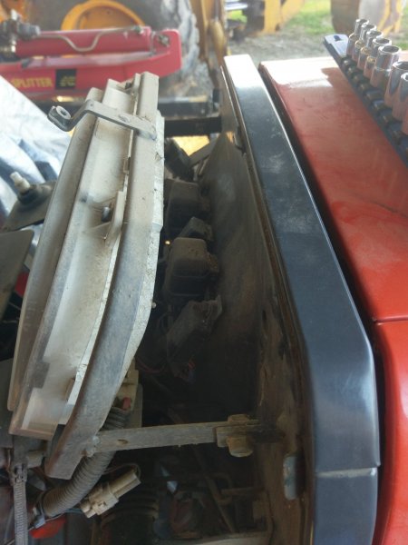

    I tore the dash off and checked for rodent damage and found nothing out of the ordinary. No noticeable corrosion on any of the wires/terminals. Battery is original from circa 2004, but the hydrometer window is still showing green. Going to have the battery load tested today after work, but I think the problem is more ignition switch related as I can change the condition by moving the key around. ( checked all fuses and they are ok)
    I know Kubs can be nightmares when it comes to electrical, but would anyone agree with the symptoms listed that it would likely be either low voltage or bad key switch? I'm not sure what else to chase after at this point. While I was running the tractor, everything was normal.

    Not a pro but that sounds like a switch issue. Similar to some we've had when trying to start and nothing but wiggle the key and bingo, it starts.

    I already have the keyswitch part number looked up. Just want to make sure I'm not overlooking something else that could be affecting it. $54 isn't too bad of money for a Kub part I guess. I am going to look very closely at connections and terminals for corrosion or chew marks before I order the switch. All mice within a 1/2 square mile better hope I don't find a chewed up wire somewhere! I'll wage a war like they've never seen! Does Sam's Club sell pallets of D-Con?? :)

    wiring, possible relay in heater circuit, does sound like the switch though

    Just putting this out there as I have seen and heard of similar problems on other makes. Check your safety switches that are on the machine for loose or corroded connections. ( seat, clutch, neutral etc. etc.)

    Took battery to auto store and had it load tested. All indicators say it's good to go, including the green dummy light on battery. You are thinking same as I was...low voltage shenanigans. Think the battery test ruled that out. I honestly think it's likely the switch, though the glow plug heater has been considered. I could get the result to vary depending on position of switch. Gonna mess with it some more come the weekend. Will report back.

    Well, I put the battery back in this evening and stuck a piece of thin rubber gasket material under battery as I had planned. Couldn't help but pull the dash off and have another nose around. I saw lots of stuff in there that needed some lubrication when I last had it apart. Again, no chewed wires, burnt stuff or corroded terminals or connections found. I think it is just the switch, so I will be getting a new one.
