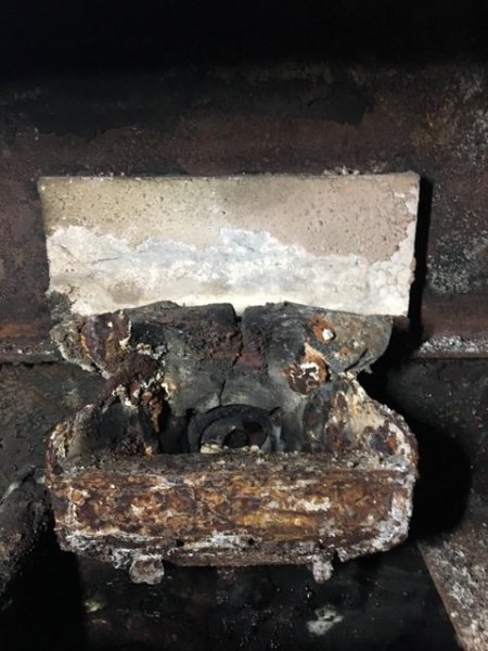

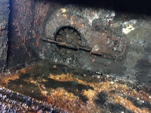

    This dang Harman isn't running.....I'm enclosing pictures to see if you guys know why..... IMG_1062.JPG IMG_1061.JPG

    Poor thing looks like its full of water ????
    Pretty skunked up too
    Been sitting in the rain ?????
    I see some nasty cracks too.

    nope......sitting hooked up in a owners basement.....P43, they cant figure out why it wont run.......

    This is clearly a gag.
    Guessing poor cleaning schedule and general maintenance, and no off season moisture control.

    I wish it were a gag.....those photos are unretouched, and the stove is actually in place, plugged in, and hooked up. Its a case of extreme neglect, and we do see these things happen out there, sadly not as infrequently as you might think.

    The part I don't understand is the large amount of water and rust.
    Our stoves stay dry year round and there is little to no rust anywhere in the cabinet.
    Is this a result of extremely high humidity ?????

    Prolly a very damp basement.I'm sure they take as good a care of their home as they do their pellet stove.:picard:

    I could not make that happen here if I sprayed a hose in the door every day, yikes.
