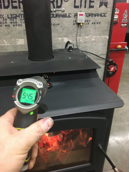

    1C7F261F-60E8-41A1-96E1-67F7A99D74F9.jpeg Got it in. 12” above stove, 6” below probe. Seems to help a lot. Same intake settings, fully closed damper, gives slightly warmer stove and about 150-200 degrees cooler flue temps. Wood seems to last much longer too.
    This is for my nc30. The chimney is only 19’ all vertical. Burning softwoods.
    JOTULMAN, mat60 and stuckinthemuck like this.
