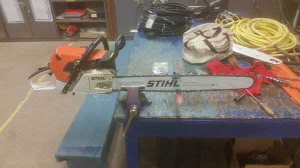

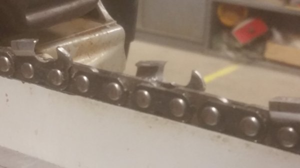

    The 28" needed some tlc....shes razor sharp now:bug:....jus a standard RS round...

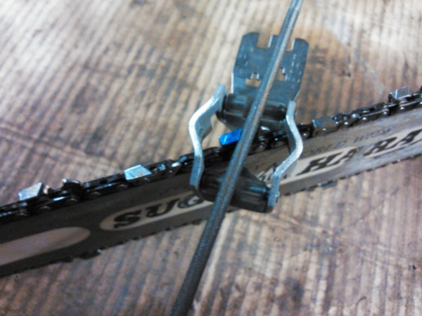

    IMO....if you hand file..the husqvarna jig is the easiest way to sharpen a chain..it has rollers on it and keeps the correct angle every time..it takes a little practice but you can have razor sharp chains very quickly...it will keep whatever factory angle...stihl is 30 degrees..

    Wow, looks like you have it figured out. What size file are you using in the Husky jig and Stihl chain? Some use the 13/64" recommended by Stihl, some stick with the 7/32" that comes with the kit.
    I use a combination of things to sharpen chains. For re-profiling, fixing rocked chains, and straightening bad angles, I use the 511ax. I have started using the Husqvarna filing jig lately instead of the oregon/Stihl type file holders. I never had really good luck with the Stihl file holder, seemed to hold the file too high IMO and the chains didn't self feed worth a damm. I don't use the Husky jig for rakers, instead I use Carlton File-O-Plates. These seem to give me the best results on the rakers.

    13/64 stihl file..
