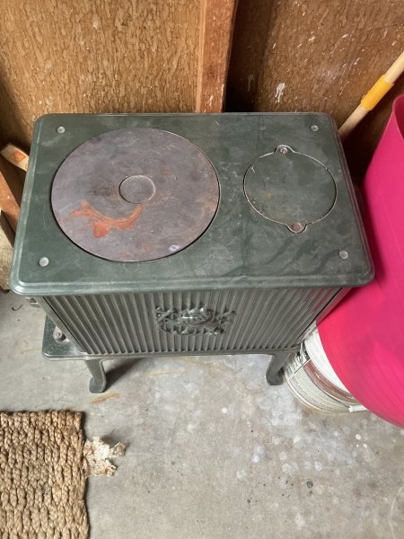

    In laws are getting this out of the house and I’m helping them get it into the market
    Anybody have an idea of the market price on this guy?
    3DDA6786-CDD6-42F9-9F29-60207E6AD4CB.jpeg 82D66382-8D36-4B3F-8D34-F1CBEF0A7FAB.jpeg 5EE9B74C-087E-47E8-85C0-BB01CCFEF982.jpeg 3E324E25-A3E6-4A2E-9111-23751AFE24E8.jpeg 1199D081-8FD1-4185-B794-95E6873A7AFF.jpeg DDF2CCBB-F308-43C0-94CD-359763A2D88D.jpeg

    Looking for some pro tips on this one.
    I’ve had a couple bites on the stove but both are hesitant because they don’t want to deal with the top exhaust cover plate screws.
    Right now they stuck. Meaning the won’t come out with a screw driver and a half arsed attempt to heat from the inside, after WD 40.
    I’ve got a couple ideas, and the first is to soak repeatedly with a good penetrating oil. I’ve got time on my side.
    What else do you have or have you done.
    Screws have been in place since new, 50 years or so.

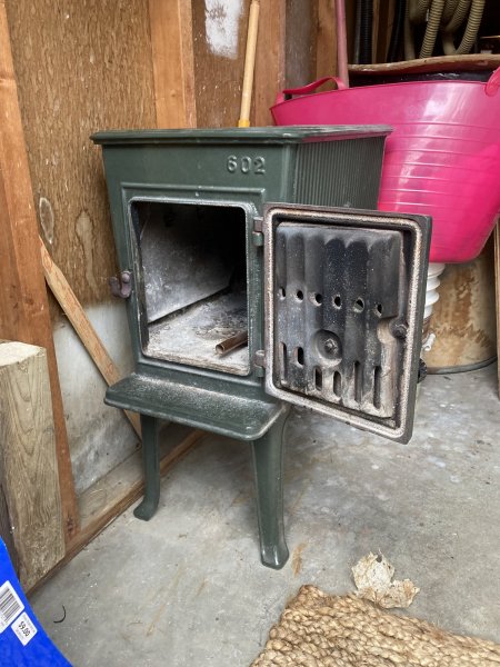

    I would say $500 - 700 cleaned up. These would get cracks on the back plate under the outlet and inner burn plates warp if overheated. That one looks good. Great little heater and easy to run.

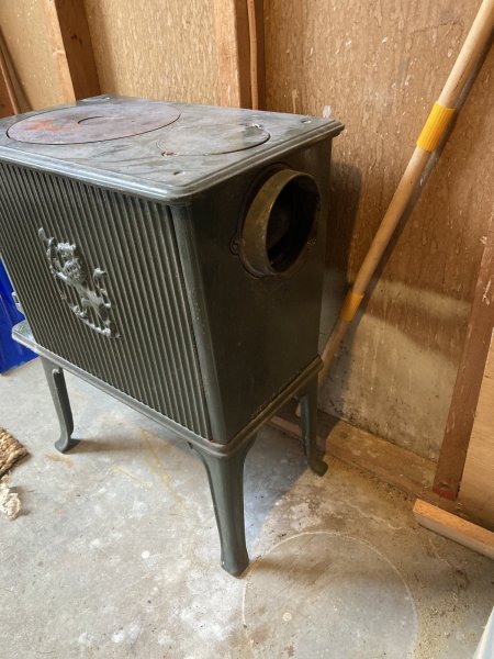

    Got a bite on CL from a guy who wants the rear exhaust.
    Easy decision
