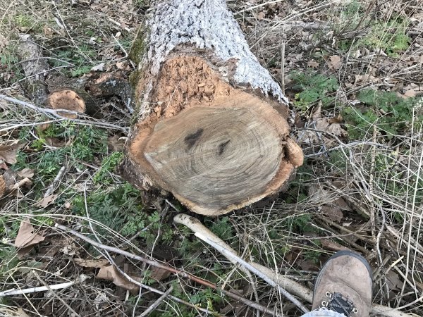

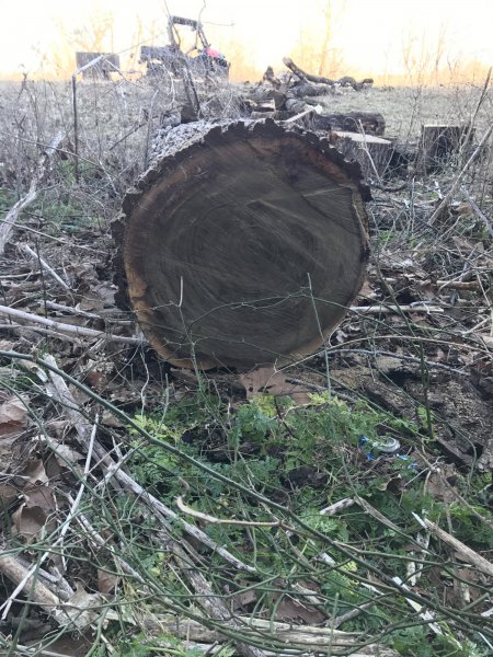

    IMG_2771.JPG Is this worth looking in to selling?
    It's 8.5' long, 20" diameter. It was dead standing not sure how long it's been dead

    Branch midway ruins it, $1.50 plus or minus a dollar

    That's worth something to the right person. I'm usually very picky about saw logs and walnut is notorious for all sorts of defect. As mentioned above, the limb in the middle decreases the value, but it doesn't necessarily condemn it to firewood. Also, there is a dark stain on the butt of the log that gives me some pause. I can't tell from the picture if its rot, ingrown bark or stain from embedded metal or something else. If it were me, I'd hire a local bandsaw miller or small mill and saw it into lumber, then stack and sticker it to air dry. Air-dried will command a much higher price than in log form, but will take some patience, like 1-2 years. You could try 4/4 for general furniture lumber, 8/4 flitch sawn (live edge) for table tops or 10/4 for gunstock blanks, the latter two commanding higher prices. If you just want to get rid of it as quickly as possible, put it up on Craigslist or better yet contact local small mills. You will get a lot more interest and money for the log if you can transport it to a small mill, rather than having them arrange to pick it up. The way to measure would be the diameter of the dark heartwood (not the white sapwood or bark) at the small end. If I guesstimate that at 16", then you are looking at total board-foot of the log at about 77 Doyle, 88 Scibner or 96 International scale.
