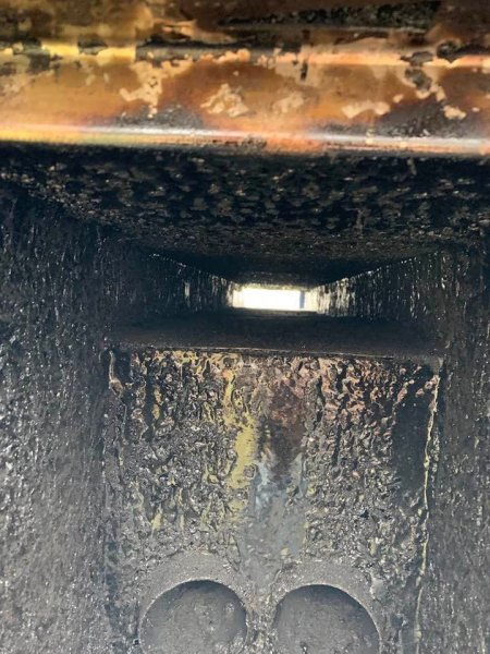

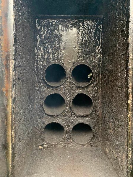

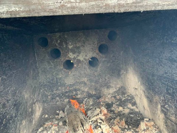

    New to OWBs, have a Taylor 750. Am I getting this clean enough? I clean it once a week.
    I have some build up in the top and middle tubes that I just cannot get out. I don't think they stay hot enough to burn out the goopy creosote. I scrape all flat surfaces and use the tube brush.
    Just looking for opinions..... 260854336_10220592759197682_2233691890313775778_n.jpg 260177338_10220592758037653_5132585652276083992_n.jpg 261387680_10220592758717670_5674517055959501545_n.jpg
  2. brenndatomu
    20,556
    128,092
    Probably about as good as its gonna get with a water cooled firebox...kinda hard to keep the flue gasses above 250* when there's 160-180* water in the other side, especially at idle.
    How long have you had this unit? Do you just load once or twice per day at a certain time?
    I know my brother said he found that their old CB used less wood and ran a little cleaner if he waited until it was calling for heat to load, and then loaded just enough to make it to the next loading, rather than filling up...my 2 ยข n all that...
    amateur cutter and mat60 like this.

    The unit is probably 18 years old or so. I've only had it for 6 months. I agree with letting the fire reduce down to just hot embers before re-loading. I try to load just twice a day, AM and PM, but as you know the weather changes how fast it burns, so in order to let it burn down, sometimes I load mid day (I work from home luckily). That nice clean dry burn along with some creosote remover once a week seems to keep the fire box pretty clean, but that back of the stove on the other side of the tubes is a mess to clean, and the 1 inch layer of gooey creosote on the bottom of the tubes cannot be removed as is, I think I'll have to wait till summer to let it harden and remove it by chipping it out.

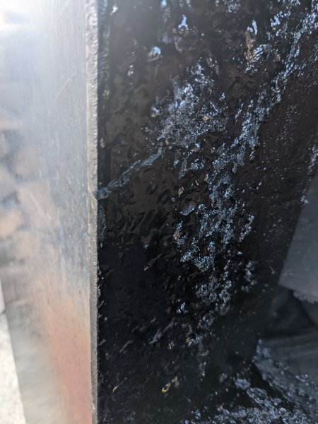

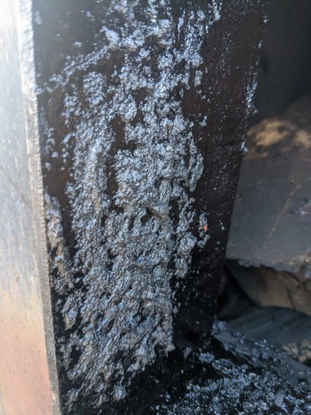

    From my boiler door frame:
    Before
    Just a couple seconds with plumbing torch.
