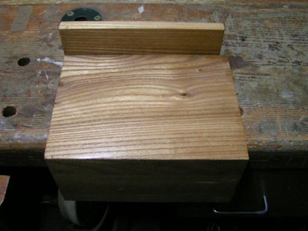

    Red Elm bench hook,made from scraps of lumber I milled in Nov. 1993 from HUGE dead tree out in the woods that a neighboring farmer owned next to parent's property.Tree was so big (30" diameter,100ft tall) that it towered over everything else on top of that ridge.I watched it for 3-4 yrs prior,Dutch Elm Disease finally claimed it a couple years later.Ended up with over 200 board feet of planks,1" & 2" thick just from main trunk before it branched out.Plus another 50 ft+ of short thick blocks/rounds for woodturning,sculpture,small boxes etc.Not to mention almost 5 pickup loads of excellent firewood from smaller limbs,branches & the upper tops.This stuff burns like coal - very slow burning,short flames & intense heat,its quite dense- similar to White Oak or
    Honey Locust.

    some beautiful stock thistle Thanks for sharing.

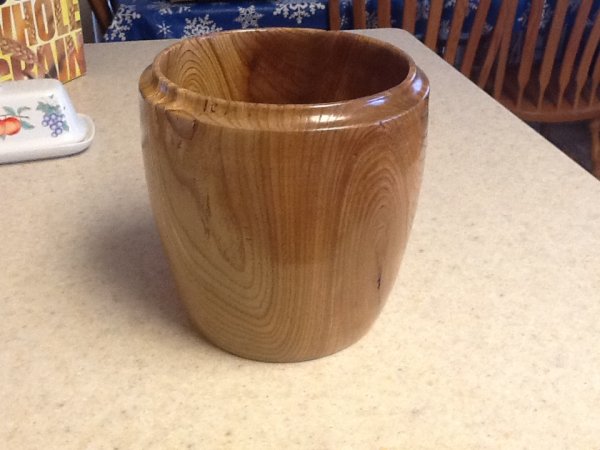

    I have had a number of red elm trees in my stacks and I found them to be excellent firewood..
    I had one that was a huge old tree, it was heavy and solid with tight growth rings, growing in the middle of my woods.
    I always thought that tree's firewood burned longer and hotter than the oak....
    Here a bowl turned out of that tree's crotch wood. My buddy had no issues with the turning or warping etc... Should make good lumber if you can find a big enough one.

    Beauty!
