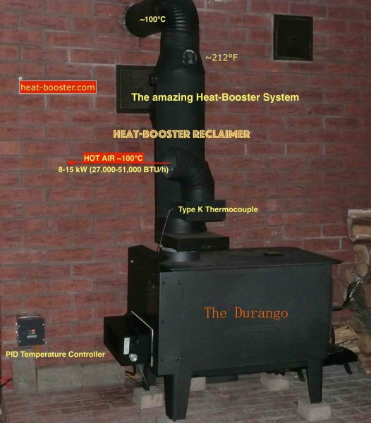

    How much heat you get into your house depends on how much wood is burned per unit time, and how much heat is lost up the chimney. I heat a 3,600 sq. ft house with a Durango stove equipped with a Heat-Booster. Only 10% of heat is lost up the chimney. A draft-booster is used to compensate for lower flue gas temperature (~220°F).
    wildwest likes this.
