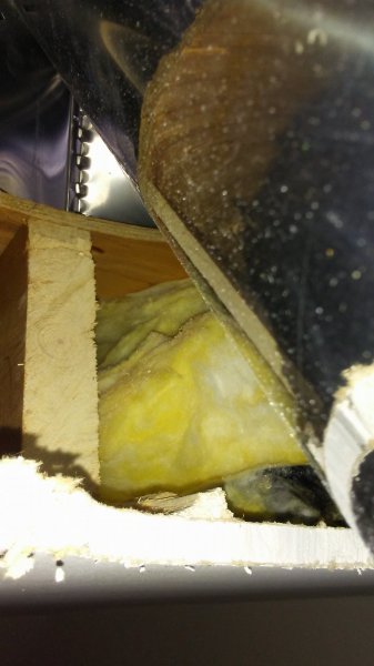

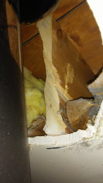

    Fast forward to today and I am removing insulation bats from the attic to completely redo my attic with blown in insulation. I pulled a bat out and looked down between two rafters. The installer cut a roof rafter to put the stove pipe in and did not support it with anything. This prompted me to open the covers that are on the ceiling around the stove pipe. ( See Pictures)
    I am not a structural engineer, however this does not look right. Furthermore I asked him after he installed if he had to cut through anything structual, he said "no."
    As the thread title states... Is my stove pipe installer a bonehead?

    That was a major bit of laziness on his part. Send him these pictures, and let the butt monkey know you will find out whom to share them with. Joist cords are very relevant in today's engineered trusses. Flex is bad, bad. Don't know how many delta rib roofs I have worked on due to this stuff. Fasteners do not magically come out. I'm glad you looked into it though. Good time of year to discover the jackassery:yes:

    Sister as long a beam on both adjacent rafters as you can, double header above and below the pipe, tying the the cut rafter back into the headers....

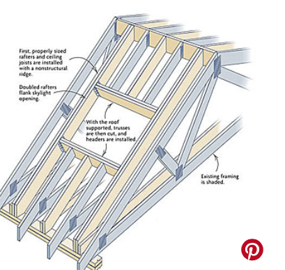

    You need to seek a lawyer because I was building, QA inspector for the US Government and your "professional" installer needs his license "REVOKED"! I am an engineer and this is completely negligent!!! It can be fixed. There needs to be a support carrier between rafters to hold/support the cut rafter. Screen Shot 2018-06-24 at 4.07.56 PM.png

    My next thought here is "Why" didn't he shift it between the rafters? There is 16" on center and you may have 24" on center depending on the construction code. They do make fire boxes to fit between the rafters.
    Show him my words and then tell him he's an @$$HOLE!!! for me! The above diagram is what is correct for safety.

    16,821
    108,922
    Thanks WeldrDave, I came to my computer to pull diagrams but you got it done! :yes: Yes his license should be Revoked for stupidity!
