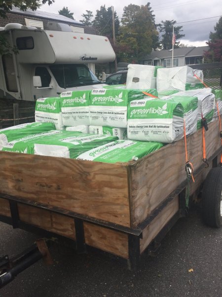

    I had plan on adding 70 bags of cellulose insulation to the attic this weekend but we had a nor'easter come through yesterday so it put my plans on hold. I hadn't picked up any materials yet and luckily I had not because I ended up finding someone local selling 50 bags of it for $200! Same size and brand I was going to pick up from HD for $12.60/bag. Saving myself almost $500!
    So now I'll just need to pick up 20 bags from HD now and borrow their machine.
    Attic will be going from r10 to r42 with the 12" blown on top of the existing batts.
    I prepped and air sealed what I could. Just waiting on nicer weather now.
