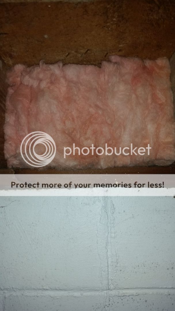

    When we bought this house I knew improving the insulation and efficiency was going to be one of my first tasks.
    So after working on years of neglect to the yard (I wanted to start off right with the neighbors) I started in the basement insulating the rim joist area.

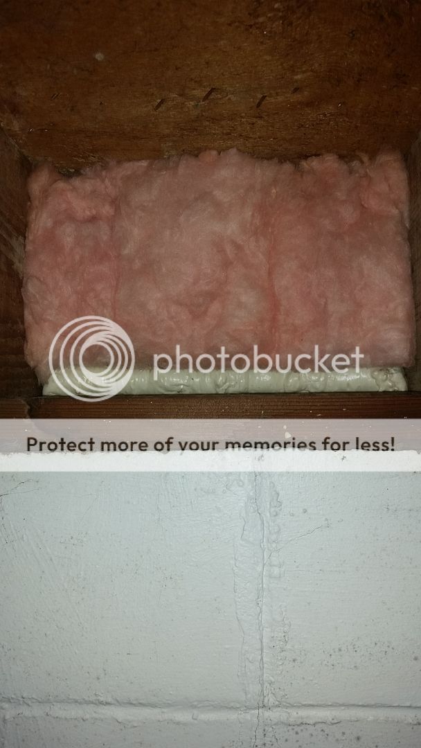

    I've tried before to just caulk the rim joist to sill plate joint to prevent air leaks but I never could get the caulk gun into that area very well so I decided to use spray foam.
    Cut a small batt to sit above the spray foam.
    Cut a larger batt to cover them both.
    Take that cold weather! Now only 35 more to go! :)

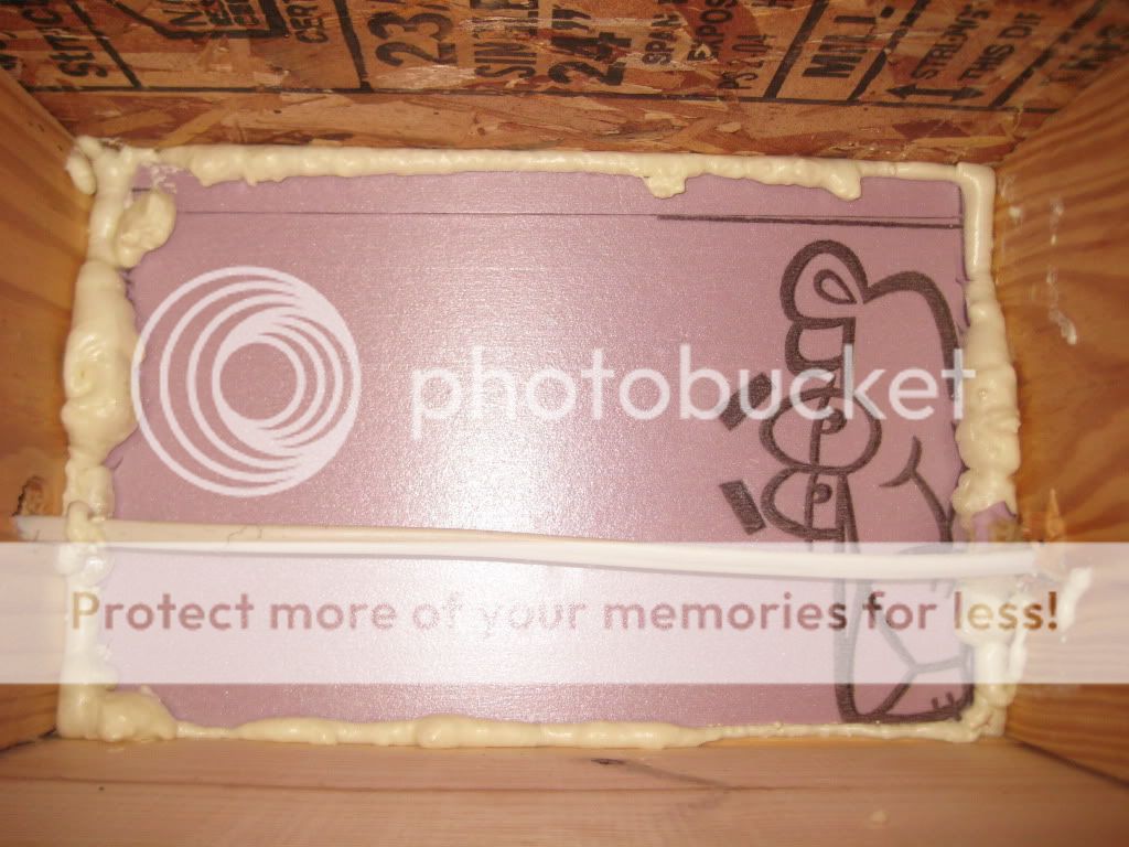

    I did the same job in my home, not a fun time. I cut and pieced in 2" foil faced polyiso, and spray foamed around the edges. If I were to do it again I would spray foam the whole bay.

    If you use that fiberglass insulation you are still suppose to put a vapor seal (poly) around the opening to prevent moisture from flowing through the fiberglass and getting trapped against the wooden joist, and the poly should be caulked all the way around for a proper seal. That's way too much work for me.
    A much better way is to cut rigid foam to fit in between the joist and then go back with a can of spray foam and seal the edges.
    The rigid foam works as an insulator and vapor seal, and best of all you don't get itchy from it or have to worry about breathing in the loose fiberglass fibers.

    The most operative word you said was "should" :)
    Yes you are right but I won't be going through that work...and with the fiberglass being free to me from some extra my brother had I will just stick with this route.
    The "no cost" benefit is a big factor looking at the other upgrades I need to do.
    I do like the look of rigid foam installation you used though!

    It might end up costing you more in the long run however when the rim joists start rotting out. Actually looking at your second picture you can see some water staining on the on the wooden sill plate already.
    I'd be checking it frequently just to make sure it never gets to this point.

    No...I had to purchase the foam. But whatever route insulation I used it would have been necessary.
    The staining you see is from is from front deck issue I'm fixing.
    I'm betting any rot I see from using fiberglass insulation will be pretty minor... I'm a gambling man I guess!
