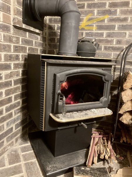

  6. Paul Dokken
    Paul Dokken
    Jan 1, 2021
    132
    391
    Waxhaw NC
    Would it be good to have it on the vertical or horizontal part. (See photo)

  8. RGrant
    RGrant
    Sep 2, 2019
    730
    4,017
    Connecticut
    Vertical is the only way I've ever seen it.
  9. DaveGunter
    DaveGunter
    3,865
    22,732
    I'd put it on the vertical portion just above the stove.

  10. Canadian border VT
    16,856
    109,143
    Vertical as gas is rising faster in that portion versus horizontal portion.

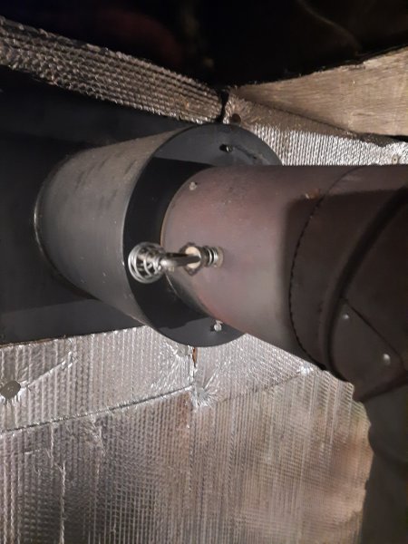

  16. SD Steve
    SD Steve
    Sep 2, 2019
    673
    4,497
    South Dakota
