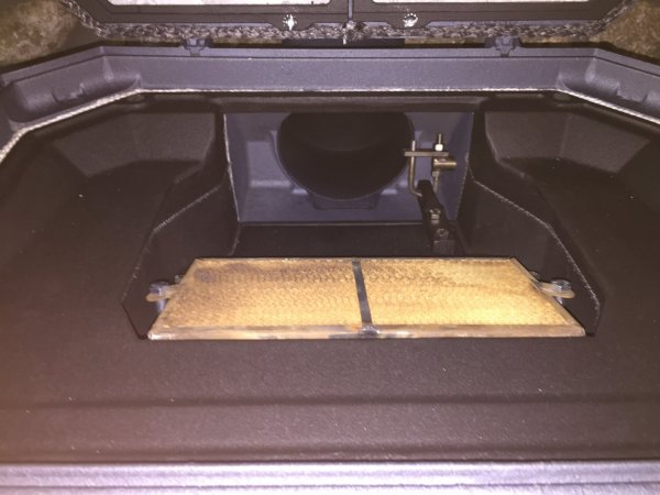

    The SS cat in mine sits into a gasket that stays with the frame. The lower lip of the cat sits into the gasket all the way around. I remove the 2 bolts and just lift the cat out. It’s light enough so the bolts need to be installed, but just finger tight, and they back right out easily by hand. I’ll try to remember to take a couple pictures next time I clean it with the cat out. Here’s a couple with it installed that I took before I fired it up the first time. Top view and from the front.

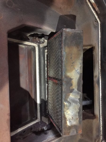

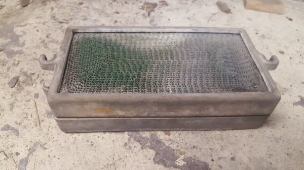

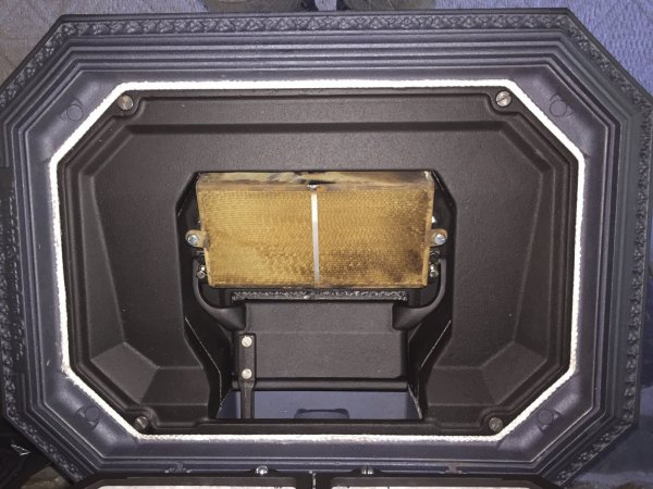

    Last Thursday it warmed up enough to let the fire die down enough to clean the cat and I took a couple shots to show how it sits in place.
    8AE6CE3C-D5CB-4AA1-A3D4-2016D681C7D0.jpeg 29309A11-F99A-46BE-89CE-E970650C5D56.jpeg 558132CE-A796-43F8-BDA5-63DDA8228FD6.jpeg
    How does that differ from yours Oldhippie?

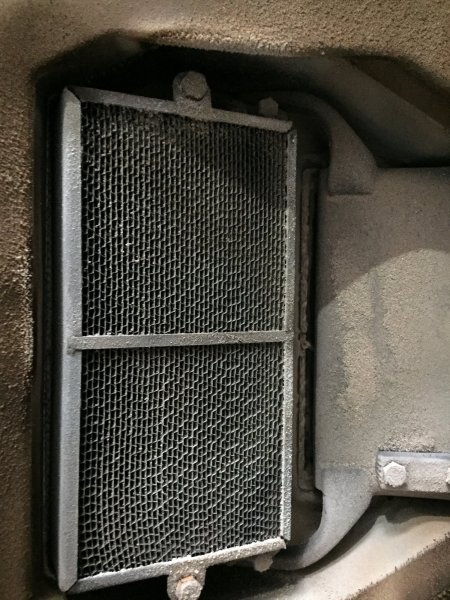

  10. TurboDiesel
    16,196
    97,190
    Doug, HolsatiaRedneck, Camber and 5 others like this.
  11. TurboDiesel
    16,196
    97,190
    My Fireview has the newer SS housing cat now
    Camber, In the Pines, Chaz and 2 others like this.

    I had the same as this picture, with the cast iron frame, and a gasket around a CAT that is similar to yours. But with yours, they have come out with a tin frame of some sort that is less weight, works just as well, but just requires to be screwed down to hold it in place.

    Thanks TurboDiesel for posting that picture so Maina can see how the old frames were. And as stated, the gasket Steve talked about was that thin gasket material that fit around the whole cat; not the gasket that is under the cat.
