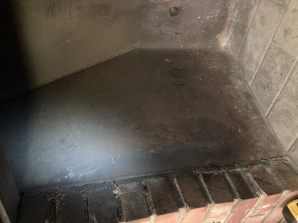

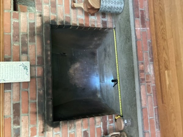

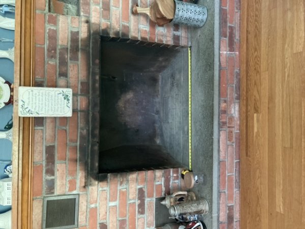

    Looking to replace the old fireplace prefab unit with a wood stove. Currently have some clearance issues created by the back of the prefab unit. I’m going to attach some pictures.
    Here’s what I would like to do. Remove the metal that’s present. It can be seen that the brick will accommodate a larger stove when the prefab backing is removed.
    For those of you who have done this and removed one of these, what steps should be taken?

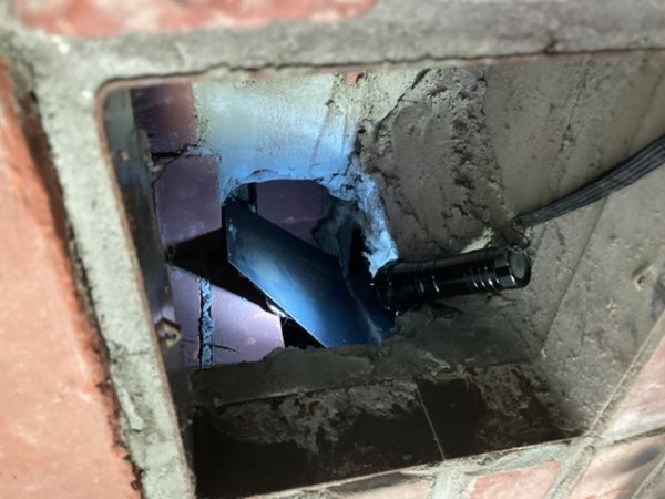

    Any idea what's behind the metal?

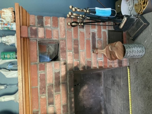

    Man my pictures are trash. I'm sorry they all turned sideways like that.

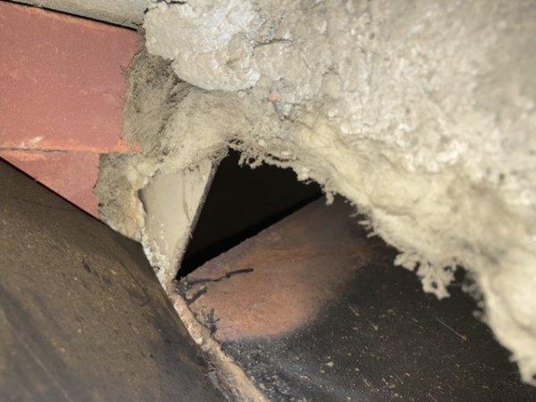

    The house has been in my wife's family since it was built. Her grandparents built it and her parents bought it sometime in the early 80's. The fireplace was an original open hearth build. The "fireplace insert" I'm not sure what to call it- is mortared to the bricks.
    I removed the heatilator vent covers and shined a flashlight in into the cavity and it reveals the brick behind it from when it was originally built.

    I'd take that out completely...then you have more room, and can much easier install a liner in the chimney and get it connected to the stove...sounds like the right way to do it to me.

    Could you retake those close ups a little further away so we can get a better look at it.
    That has been one smokey fire place. As a fire place, there's a way to help with that smoke, by adding a piece of flat steel across the top to shorten the opening. They sell them pre-made, or you can make your own. Of course, I know you're thinking about putting in a stove it sounds like. You're having clearance issues with that I take it?
    I'm not sure if you already have a stove to go in there or if you plan on buying one. IF you were to buy one, I would first ask around (here or some chimney sweeps...here or near you)...and ask about a stove insert versus a free-standing stove set back partially in the fireplace opening. I know many folks are not big fans of setting a stove back inside a fire-place like that. Sometimes and in certain situations though a person is limited.
