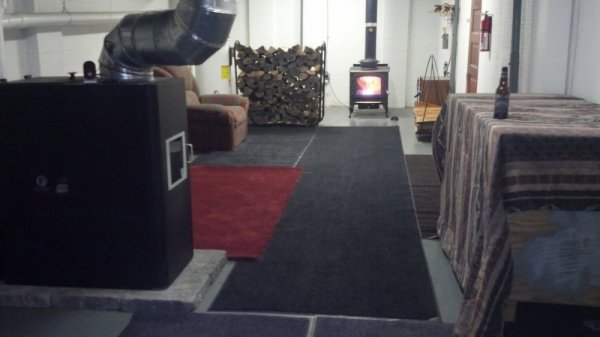

  13. DexterDay
    DexterDay Administrator
    12,411
    31,632
    Northeast Oh
    If your worried about a mess? Then pellets would be more suited to your lifestyle?
    Do you remember what wood burning was like?
    And as far as storage goes for pellets? How much room do you have for wood?
    Only reason I bring pellets back up, is, if you have to buy wood? Why not buy pellets? Only need to buy what you burn. With wood, you will find out, that having at least 2-3 yrs worth of wood on hand is ideal. If you burn 4 cord a year? You will need room for 8-12 cord of wood out back?
    There are pellet furnaces on the market that tie into existing ductwork also? I have one and love it.. And I burn wood to. But wood is far messier and takes up way more space.
    My 2 pennies... As you were.
    (Pellet furnace on left)
    papadave and Gasifier like this.
