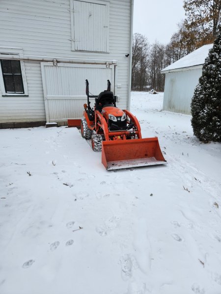

    Went out to get tractor going to tidy up the snow in the driveway....started up hard..but not bad considering it's well below ZERO here. Pulled it out of the barn after a few minutes to finish warming up....walked away to go inside and get warm. Poor old girl died. Never to stay running again lol. Seems I have an ice/ gel problem. I'm pretty lucky.....ive been running equipment all my life..never had this issue. I'm not even gonna bother changing filters or anything...cuz they will plug too. If all else fails..ill tarp it over and put a space Heater under if I need too. Otherwise..its staying put till it warms up .
    Also started putting conditioner in my fuel months ago to prep for this. Too much moisture in my system :(
    Btw..I really hate these cheap plastic filters that Kubota is in love with in there smaller equipment. Theres 2 on my BX...and im unimpressed. My Dad's RTV has had troubles too. The equipment with the better filters have had zero problems. Might be time to upgrade.

    We took the heat gun advice...got her running..cleared up and sounded good..but decided not to press my luck. Safe n sound in the barn now ! Actually shook so hard on initial startup...that it loosened a radiator hose clamp. So had some nice green flinging around to boot lol !
