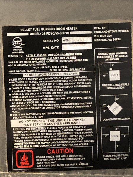

    My cousin and her husband have a pellet stove- the specific model is the England's 25-PDVC / 55-SHP 10 per the stamp on the back of the unit. In conversation with my cousin's husband he said that he wasn't planning on using the pellet stove any more because his electric bill was through the roof. I was a bit surprised but didn't think much of it. Then we had the conversation again and I got curious so I watched a few videos online and an idea stuck in my head.

    Here’s the stamp on the back of the unit.
