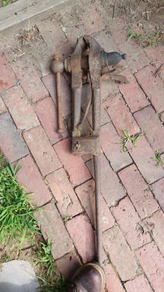

    This post leg vise was left at the dumpster at work a few months ago. I finally got around to cleaning it today. Tools like this are often overlooked and sent to the scrap pile. It is covered with surface rust and years of dust. It is complete with mounting bracket and flat spring to keep the jaws open. I needed a "softer" vise with worn jaw edges. My bench vise has hardened steel jaws with square edges that can mark up the work pieces.
    I just ran the angle grinder with a wire wheel over as much as I could reach. The tight areas were left alone for now. This vise was most likely forged in a factory by smith's using a steam or water-powered trip hammer. It took skill to turn the bars into the final shape. The slight irregularities can be seen in the chamfers.

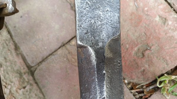

    On this leg, heavy force was put on the vise causing it to crack almost all the way through. The handle also is bent from to much force.
    The smith that repaired this used another piece of iron and forge welded a repair plate to give the leg strength. This was done in the days where tools were not just thrown away.

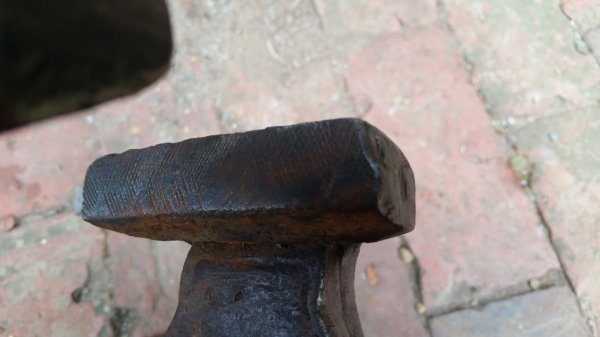

    Here it looks like the hatch marks on the jaw were made with a file or chisel. 20150809_094742.jpg

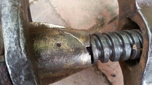

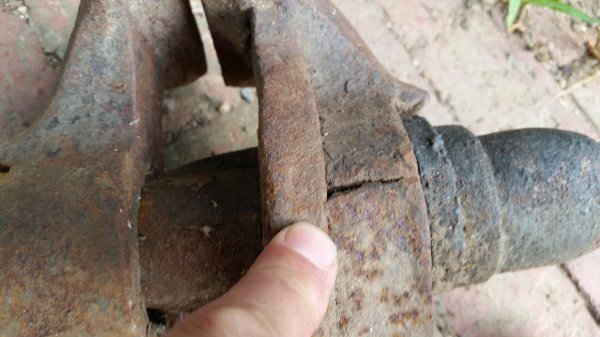

    The screw box took a beating at some point, possibly when the leg cracked. For the type of work I do, it should not be an issue. The screw itself is really clean with no slag or filings in it. It may have been cleaned or replaced at some point. These types of vises were repaired and rebuilt frequently form spare parts from other vises.

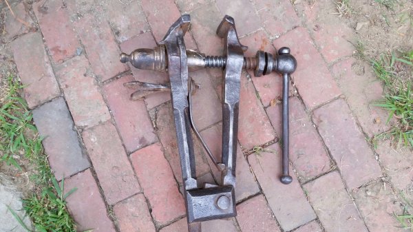

    This is a beauty that was hidden under the rust. It is now cleaned up and wiped with oil. It is ready to get mounted to my bench and go to work. I will appreciate this for years to come.
    There are no manufacturers marks or stamped letters that I could find on it. This vise must have meant a lot to the smith who owned it. It may have been critical for his farm, home or business that it needed repair. The stories are forever lost in time.

    I did a bit of research on this one this evening. It seems to have been made in England between 1800 and 1830. The tenon mounting through the back leg is a good indicator. The screw box is a brass color indicative of the brazing method used to make it. Lots of forging tools jumped the pond back then.

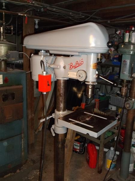

    Here is a pic of a Buffalo drill press that I recently restored.
    It was given to me by a friend who did not want it, it had been stored outside so it was in rough shape.

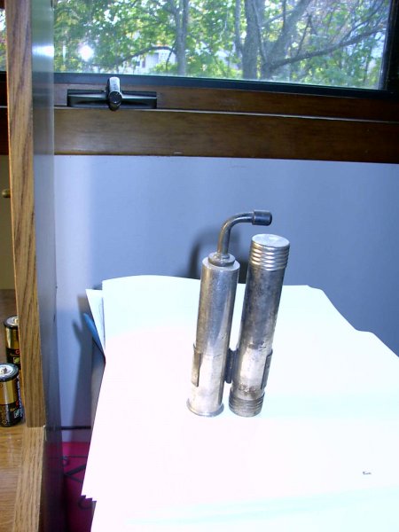

    Also old alcohol torch, I have no idea where I got it from, but it is a nice item.

    Ah, I remember that from another thread. That is a nice restoration you did. My dad has a Walker - Turner drill press from around that time. They have a certain industrial look about them. Great quality compared to what is out there now.
    Buffalo forge was a huge maker of all sorts tools and machinery. I'd love a rivet forge and hand crank blower.

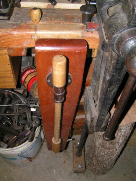

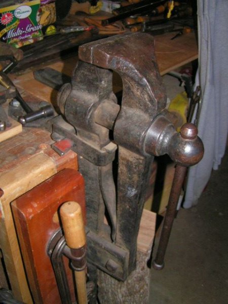

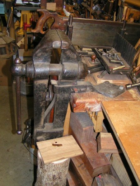

    One of the best buys I ever made was this unmarked yet factory made late 19th century 70lb post vise at a local farm auction sometime in the mid 80's. $25 for that & unlike most that I've seen for sale online in the past 15 years was stored/used inside away from the rain/snow.
    Went to literally several dozen local auctions (pretty much every weekend I wasn't working) for at least 4 years before finding this one vise. Back then they were never found in the 4-5 county radius where I went hunting for old tools,certainly compared to other regions of the country.I've seen totally beat to death post vises with broken or missing spring,handle twisted like a pretzel,stored outside/rust covered go for $150+ shipping on Feebay.Its insane....:loco: :crazy::rolleyes: :hair:

    I remember that vise too. Bolted block on the floor as I recall. The beauty of these vises is being forged, they could take a beating. Not like cast iron bench vises that could break under a hammer strike. Yours is in great shape complete with the spring, mounting plate and wedges. So many of these vises and early english anvils were not marked as there were a lot of manufacturers making them. It is great to see old tools still being used.
