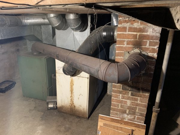

    Hi all,
    Im not sure if this is the right section to post this in so let me know if I should post it elsewhere.
    I recently bought a 1400 sqft home with an uninsulated, unfinished basement. Currently there is a wood furnace/oil furnace (with ducts blowing to each room) in the basement hooked up to the chimney. We would like to get rid of these furnaces because the configuration of the furnace exhaust is not to code and is highly susceptible to creosote buildup (exhaust pipe goes 90 degrees from the furnace, then almost horizontal for 5 ft and then has a ~ 60-70 degree elbow to the chimney)
    We were thinking of putting a regular wood stove in place and then cutting vents in the floor for the hot air to rise into the house. After reading up on this, it would be useless since most of the heat would be absorbed by the cement walls unless we insulated the whole basement (can’t do this because it’s an older foundation that leaks in some areas and also we can’t afford to insulate the whole basement.)
    My idea is this: install a regular fireplace in the basement and hook it up to the existing chimney. Then build a 10ftx10ft (or whatever minimum size that would still have safe distances from the fireplace) insulated room around the chimney/new fireplace and install a vent in the ceiling (upstairs floor) for the hot air to rise into. I would of course need a grate/vent somewhere on the walls near the floor in that fireplace room for passive air to enter.
    Does this make sense? Any thoughts or inputs?
    Extra info: This is not our primary source of heat. We have ductless heat pumps that heat the house and we would like a wood stove for extra cold days and because I just like to cut and burn wood. This does not need to heat the whole house, just the living area above where the furnaces are now.

    I have similar chimney set up. To picture my setup remove both heat sources you have. Place new furnace about 4 foot from chimney. My furnace has a rear exhaust that has a 22.5 bend, 3 foot straight sloping up, then 22.5 bend into chimney. Furnace has shielding around it to heat air around firebox and it's own HVAC blower. Top of furnace has 14? inch air duct into main HVAC ducting to heat the house.
