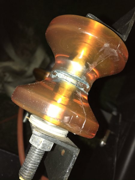

    The poly bow rollers on my log splitter/atv log lift must’ve jammed up a bit last time I used it.
    Noticed the winch rope burnt a slot in them. Ordered some new ones but at least 8 days out.

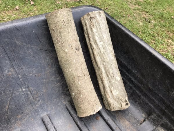

    So,,,out to the woodpile. Found a nice stick of musclewood/ blue beech and a hickory just in case.

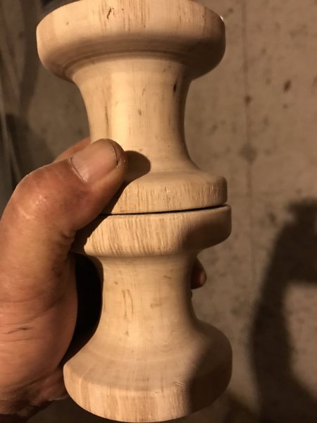

    Dusted off the lathe which has been quite dusty and rusty and made myself some new spools.
    FWIW the ironwood which was cut and stacked this spring was around 20% moisture 4” into the round.
    7” or so went up to 25%

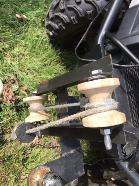

    I’ll drill the holes tomorrow and mount them. Occurred to me maybe a full wrap on the rope around the spool will guarantee they spin. Possibly abrade the rope more but we shall see how bad.
    Far from perfect, done all by eye in the dark basement but they’ll do, at least for now.

    Not redneck at all, just a perfect solution.
    Now cancel that order. The two you made will outlast you.

    Maybe. They spend a lot of time outside and I wouldn’t want to oil them. Always good to have extras. Thanks.

    I figure most treatments will make it slipperier and might chemically react with the synthetic rope.
    Occurred to me just a while ago. I have a cheery handle on my doorbell outside. Made that 27 years ago and it’s been out there since. Maybe they will hold up well. There’s always more wood :)

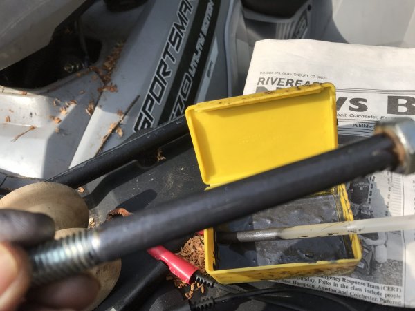

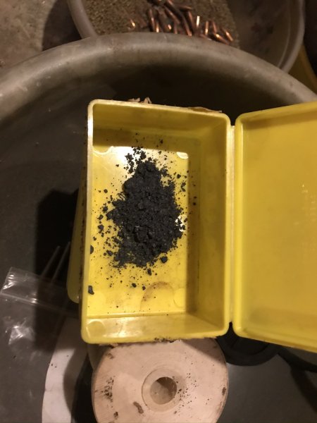

    Decided to lubricate the bolts this time around. Dry lubricant Tungsten disulfide (WS2). Mixed it with a carrier which happened to be brake fluid because it was the closest bottle :)
    Confidence is high. We won’t speak of morale but confidence is still high.
