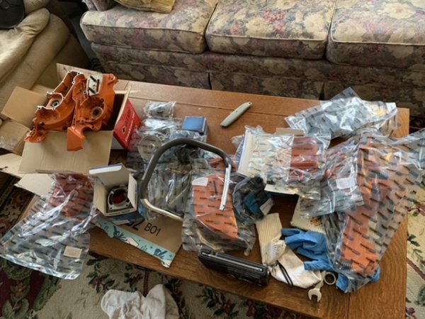

    So I’m a husky guy and for saws I like Husqvarna too. Dad was a Husqvarna man, that’s probably where I got it from. I’ve got a stable of older 2 series saws, including dads 266xp, they work very well.
    Been watching the internets on those Chinese knock-off saws for quite awhile, reports seem to suggest there getting better year to year. It’s winter and I needed a project. Yup... I plunked down my $216 via PayPal and a week later a box of parts showed up. :ups: A genuine part-for-part Chinese made copy of a Husqvarna 372XP. No instructions, just a bunch of parts, bolts & do-dads all individually sealed in plastic bags/smaller boxes.

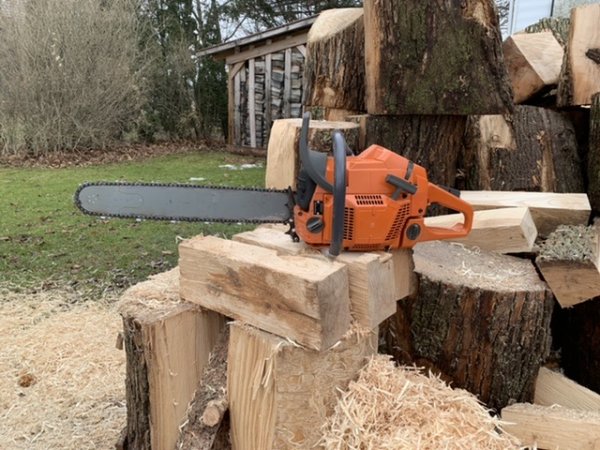

    I watched a few YouTube videos last week and BAM.... 7 hours later (yesterday) I had a new saw. Toughest problem I had was figuring out which length bolts to use where. No parts were left over. Let it sit overnight so the gasket stuff had time to set. Today I gassed/oiled up the beast, no leaks, and it started on the eighth pull - WooHoo! A few minutes with the carb screws and she runs great. I threw on a bar & chain and went to town. Below are a few pics - all the parts and then with the saw with some freshly cut wood & noodles.

    I consulted YouTube. There is one guy on there who goes through the whole build. This was not hard. A set of screwdrivers, allen keys, a razor knife, plastic hammer mallet, and scrench handled virtually all of it. I did buy a set of ring compressors so as to make inserting the piston into the cylinder easier. Doable without but a pita. I also used a small heat gun to assist with crank and case assembly. Bearings came installed in the case half’s. I put the crank in the freezer for an hour and at assembly time I heated the inner bearing races with the heat gun. It all press fit together by hand.
    My initial observations...
    - Mechanics seem solid - time will tell on how long things hold up.
    - Plastic case parts fit/finish are not up to Husky standards.
  11. Woodsnwoods

    I have several of those I've been running them over two year's.
    Other than some of my pulse and fuel line's
    Failing.
    I switched to quality echo line.
    They have been great I've cut hundreds of dead
    Ash mainly with them.
    They are a lot of saw for a couple hundred dollar's.
    The pre assembled are just a few dollars more
    If someone doesn't want to build one.
