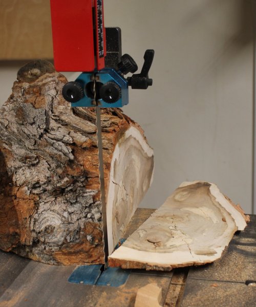

    Laguna 14Twelve.

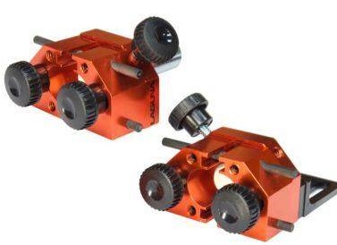

    Ceramic blade guides. Micro fine adjustable. NO heat build up.
    Takes 1/8" to 3/4" blades.
    Phenolic plastic mini guides for the 1/8" to 1/4" blades.
    Phenolic rods are adjusted to the blade. On first run, the teeth
    trim the plastic away, unharmed. It does not get any better than this.
    Resaw and mill rough material w/ Laguna Resaw King blade.
    I resaw down to less than an 1/16" and rough out logs for boxes
    w/the Resaw King. It will eat up anything and comes out
    smooth as the proverbial babies butt.
    The only saw better than this is a more expensive Laguna.
    ...last thought. Ceramic guides.

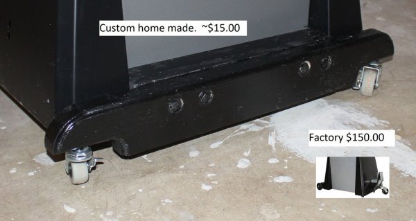

    It weighs #3oo. When I got it home I unpacked it in the
    truck and brought it into my shop piece by piece.
    I rigged my own wheel set to make it mobile.

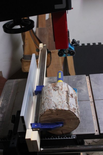

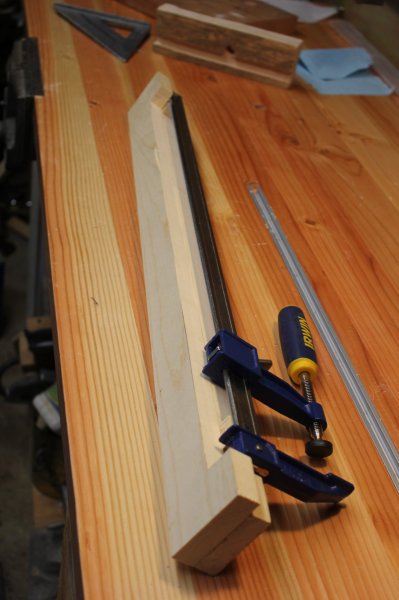

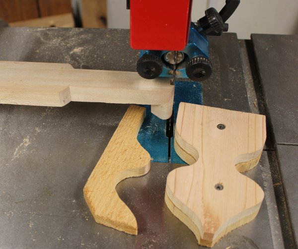

    Couple of my home made enhancements to Maximus.
    Pattern guide. Use it to create fancy fence pickets.
    Fence to cut raw logs.
