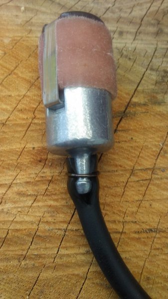

    All of the supplied china fuel and pulse
    Line's have failed.
    I swapped them out for echo 3x6mm
    Fuel line.

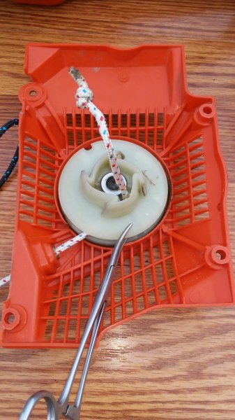

    I broke several starter ropes so i bought
    A roll of true blue 4.5.
    Cut most of the "g"off the circlips
    They are a common weak point
    Oem circlips are preferred.

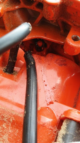

    Some use nachi skf or fag bearings. 20180618_184707.jpg 20180616_192048.jpg 20180625_184109.jpg 20180326_124138.jpg
    No problem after that I've been cutting for a year with them
    Not oem but well worth it to me

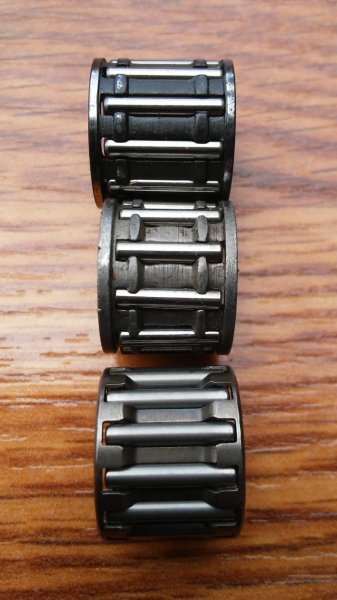

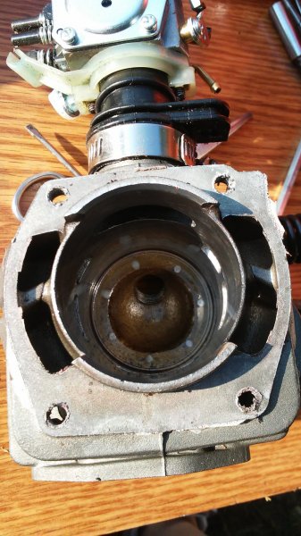

    20180623_154315.jpg 20180623_144658.jpg The wrist pin bearings at least on mine
    Are odd
    They are larger diameter than oem.
    But the id is the same.
    They resemble clutch bearings
    Just longer.
    So i bought oem clutch bearings
    And used them as wp bearings.
    The bottom bearing is oem.
    The farmer tec/huztl cylinders
    Usually are good to go
    Check for sharp port edges
    And casting flash.
    The squish is usually more than
    Oem.
    That's why i run popups
    To get good comp.

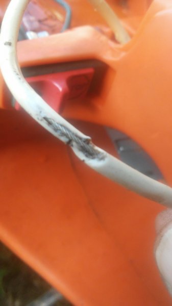

    20170513_175708.jpg 20180616_091522.jpg 20180623_124354.jpg 20180523_101007.jpg 20170930_130403.jpg a few failures I've had
    Hemostats make it easy to swap line's and rope

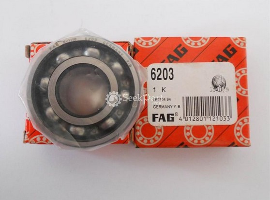

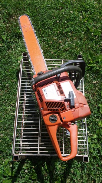

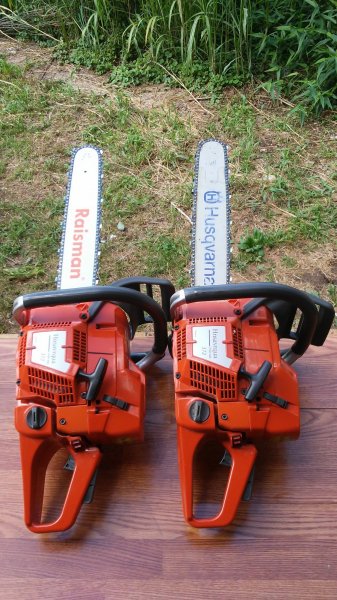

    I'm doing this 99 371xp
    It's getting a meteor with cabers
    Fuel and pulse echo line.
    China Seals muffler and throttle cable.
    Rebuilding this for a friend.
    He painted the bar orange
    And it stuck to the bar plate lol 20180628_144458.jpg 20180628_151436.jpg 20180628_151016.jpg 20180628_162705.jpg 20180628_172652.jpg one of the fastest saw's to rebuild as well
