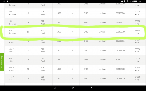

    The bar on my saw is starting to wear out. It takes a 72 link chain but somehow I ended up with 2 80 link chains. Could I switch to a bar that works with 80 link chains or would I need to get a new drive gear as well. Any recommendations on bars would be welcome.

    It looks like you can get a bar for those chains, if they are.325 .050. This chart is helpful.
    Link: Bar and Chain Fit Up Chart

    Sorry for the confusion I had. I have a 20" .325 pitch .050 width with 80 links. It looks like I have to use a .325 pitch chain since my drive great is for this. Thanks for all your help. Chain sizing is complicated to me
