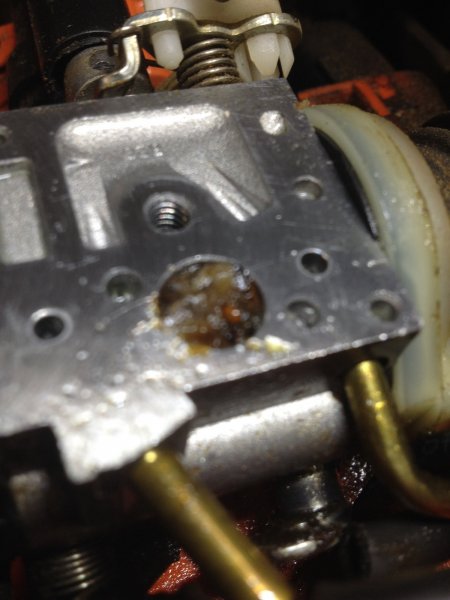

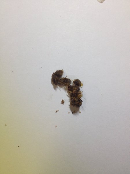

    a coworker bought this saw from a rental store a couple years ago and have casually used it until it started acting up yesterday. It would idle all day and free rev with no sign of acting up. I thought he was crazy and went to the wood pile. He was right, as soon as it got under load it would die.
    I put it on the workbench and opened the carb. Here is what I found.
    I couldn't believe how packed it was. No wonder it was starving for fuel.
    Turns out it had no fuel filter at all. Owner said he had never messed with it. Goes to show you anything can happen and you should check all the basics first.

    I would check the compression and check for damage to the P&C. Hopefully a bullet was dodged, but you know that sucker was leaned out from that.
