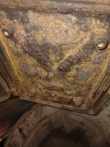

    Lets see if this works, took it outside and rinsed it out with a hose, got enough out for now to work on it without getting covered in ash, will pressure wash things later.
    Inside the firebox:
    More to the front of the firebox:
    Down below:
    Where I washed out out:
    MUCH better than how it started:
    I THINK the pinhole was somewhere in this yellow circle:
    I now have a box fan sitting on the top "cleanout" opening pushing air through to push the "loose water" out.
    Before I go to bed, I will put the heater in the bottom and hopefully finally start to dry everything out.
    Once it dries back out, I will get the air hammer with the chisel blade back out to finish removing the large chunks of creosote and the needle scaler to clean up the walls.
    Once I can see the walls better, I will plug the openings in the boiler back up and pressurize it so I can mark the leak point(s?) and decide where to go from there.

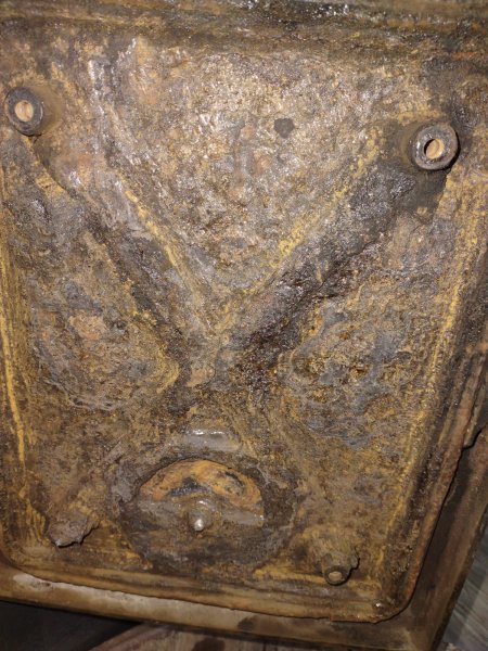

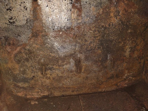

    Got the back wall cleaned off tonight:
    Surface rust, but it doesn't look bad. No significant pitting or erosion that I could find.
    Started cleaning off the door (so it doesn't put creosote on my arm all the time) and it is the rusty mess that I was expecting the back wall to be:
    Going to have to replace the insulation and the round vent adjuster as it is rusted through.
    Snapped off my first bolt (lower left on the door), will weld a nut to it and see if it comes out.
    If not, I will center punch, drill and try not to snap off an extractor in it.
    Aaron Z

  17. brenndatomu
    20,438
    127,192
    Could easy still be a pinhole there though...likely actually.
    Screwloose likes this.

    I agree, will hit it with the angle grinder and a wire wheel to finish cleaning it up and see what the soapy water says. Might go so far as to paint the rusty parts with high temp paint once it's done.

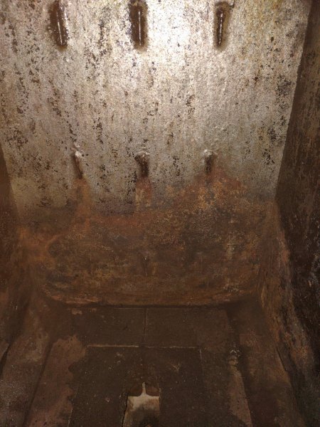

    Pressure tested it today, found 4 leaks in the back wall.
    Top right is the one that was leaking when I saw it, the others are pinholes: [​IMG]
    I am going to bet that the gasification part did NOT work properly after they replaced the firebricks, the nozzle brick was installed backwards so they had no flow through the nozzles.
    This end was towards the door: [​IMG]
    Instead of this one (they're supposed to be one unit, but it broke in the middle and now there's two halves): [​IMG]
    The backside of one of the nozzle bricks: [​IMG]
    The outer bricks look ok: [​IMG]
    Some closer pictures of the back wall after taking a wire wheel to the leak points:
