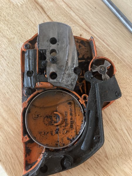

    I took the cover off my rancher 450 when the brake was applied. Now I cannot get it to release. How can I do this with it off the saw?

    I had to do this for a coworker a few years ago… I chucked up the clutch cover in a bench vise with some wood scraps helping the vise to only bare on the flashed surfaces and then worked the jaws of a cheap pair of vise grips into the piece that the chain brake flag engages when mounted on the saw. Worked like a charm.

    I’ve also put it back on as far as it could go, applied pressure enough at the handle driver until I could feel engagement and used the handle as it is normally used

    Put the clutch cover on and push in on the top right corner. And take the brake off

    The brake is engaged so there is no way to even put it back on partially.

    I tried that and it felt like it was moving but it didn't unlock it.

    Take the clutch off first.

    yup, that’ll do it too.
    There’s a little more to removing the clutch than what Taryl shows though.
    you’ll need to stop the piston with a shoe string or something soft
    I made this video for a fellow hoarder just a little while ago. This 350 is coming in handy

    Thanks for the video link. I wasn't able to get it to reset but this one worked:
