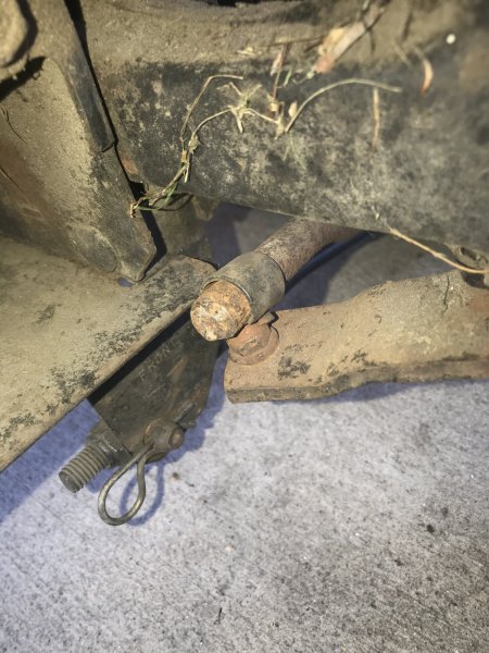

    What is the best way to fix an LT-1000 tractor steering rod that popped off?
    Looks like there is a very Small & slim rubber Hold down strap that broke. This would explain why the rod popped off.
    The rod has a hole that fits over the ball. See pics.
    What is the best way to fix it?

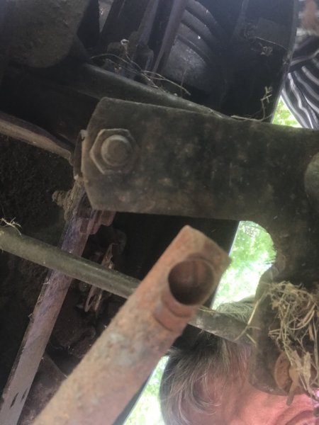

    On this photo, doesn't the metal sleeve slide over the ball to retain it?

    Yes but it is rubber and broken.

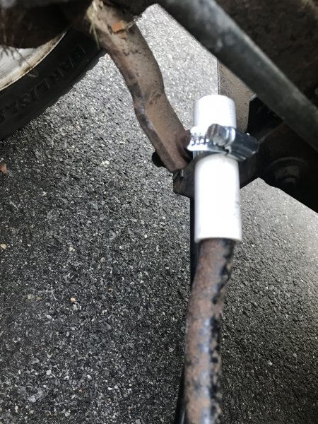

    How about 1/2” pvc pipe with a radiator clamp for a no welding fix?

    The rod & ball is fine but the steering link with the hole in the bottom keeps popping off the ball. :-(

    OK, so we are using different descriptors, but I think we are both talking about the round part, not the flat part. If so, I will change to your terminology. The ball is part of the steering link (round part), it bolts to the flat part.
    So I see three options:
    1. Replace the link with the ball.
    2. Use a bungee cord or something similar to keep them from separating.
    3. Remove the ball, drill through the link, replace the ball with a bolt, then a nut, then the link, then a double nut or locknut on top of the link.

    At first I scrounge around and found 1/2” Pex but the inside diameter is smaller than PVC ! I never knew that! Why smaller?
    Anyway, I had some car water heater hose that was the right inside diameter but when I went over a bad bump it popped off.
    Therefore I got the 1/2”diameter 2 foot PVC Home Depot for $1.31 and hose clamps From Harbor Freight 40 assorted for $5.19 I used 5/8” clamp and it fit fine

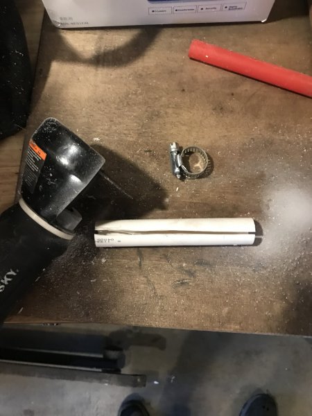

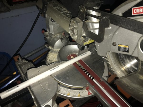

    Cut the pvc on the chop saw and slit it with the pneumatic air grinder. Then slid it on and clamped it down.
    So we will see how this works. :)
