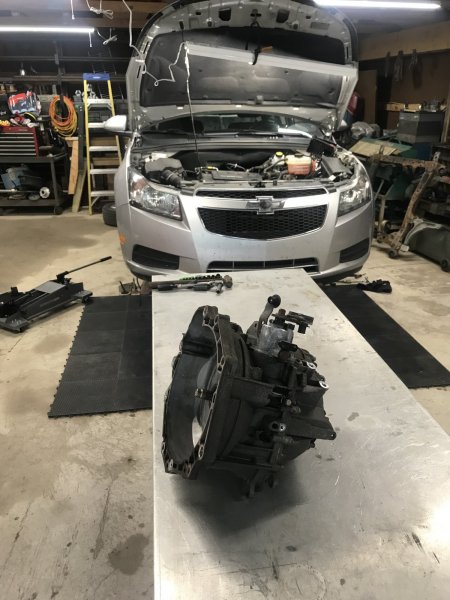

    C4B271CD-500D-41B7-B337-28B8129E734C.jpeg Transmission in my car has been making some bearing noise for a few months now . General Motors does not service this transmission… no parts, replacement only. Now, at my cost of $3600… not going to happen. Found parts in The UK…. $260 for the bearing kit …. Let the fun begin. :yes:

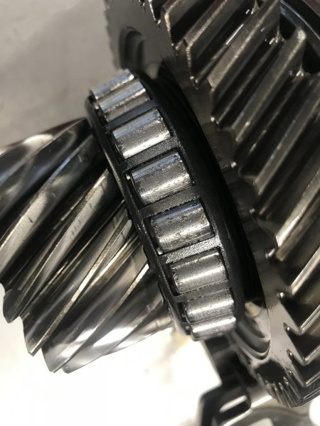

    A few moments later…. 16E010D9-0D20-4233-9FB2-050632F8C2CF.jpeg 22D50E0F-F648-487D-A2F8-4CBBD39D702D.jpeg

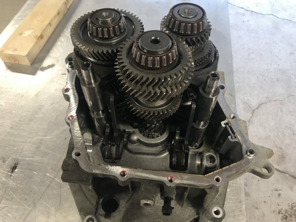

    E4BD5008-9304-4792-9694-8D83554D85EA.jpeg And here is the major winner … :makeitrain"

    31,287
    What is special about the bearing that you had to get it from the UK ?

    A stick shift! There's something you don't see anymore!
    Is that a proprietary bearing, or you just didn't want to wait to get it apart to see what # it is?
    Years ago I was just dumb enough to buy a Dodge Caravan with a bad trans bearing (4 cyl/5 speed if you can believe that!) But I got lucky in that I was able to replace all the bad parts (couple gears and bearings) without even removing the trans! Local trans shop was able to get all the parts I needed piece meal.

    Might have been able to source bearings, but wasn’t to comfortable with that . There is no stock on kits in the USA.

    Some serious spalling on that bearing.

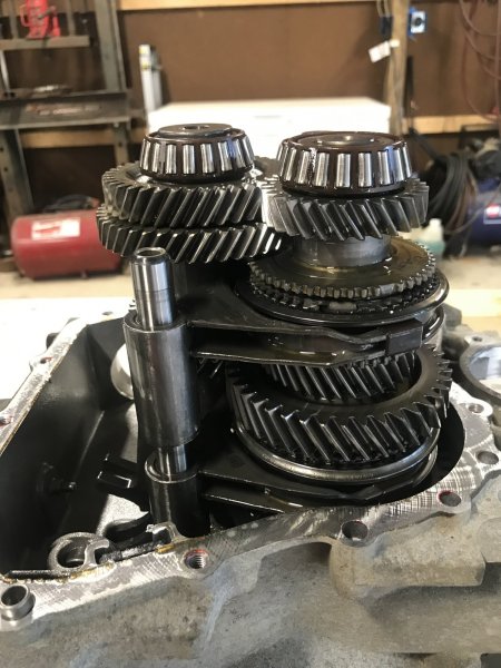

    Shafts all rebuilt… ready for final assembly in the morning… then stuff it back in the car… :D
