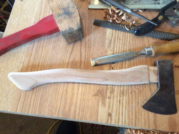

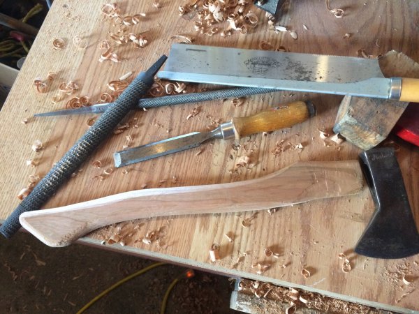

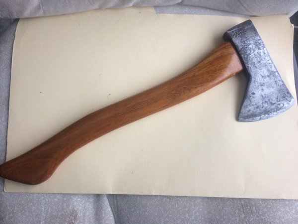

    A few years ago I stumbled upon a Norlund "Voyager" ax head among some miscellaneous junk...A few days ago I finally decided to carve a handle for it....I had some beech which required some dressing and cherry which was basically ready to go....I realize the beech is a better wood for an ax handle however since this little ax will likely not see too much action, I decided to go with the cherry. The finish is 2 coats of shellac and 3 final coats of urethane. Here are a few pics of the process.....Twister
