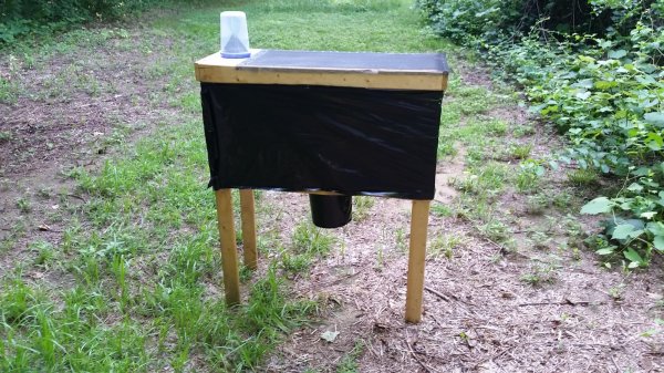

    Saw a horse fly on the stornoway screen today. I built a trap a few weeks ago and set it out this afternoon in the small clearing in the sun. By 6 pm I caught 2 deer flies. Hot weather for the rest of the week, so I will see how it goes. They say the flies like movement to attract them to the trap. I'll rig something up. I need more brown paint too.

    Update on the trap. I emptied the collector container today. A handful of horse flies and two deerflies. The deerflies are very aggressive here and I did some more reading up.
    I stapled a black trash bag around the outside of the trap. Flies like the color and it makes them zone in on the heat it creates. I also added a hanging coffee container with a wrap if bituthane on it. The container moves in the breeze attracting flies and if they land on it, they may get stuck. If I can reduce the numbers we will be happy. Mosquitos are minor compared to the deerflies. I'll update if I get good results.

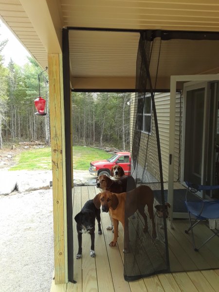

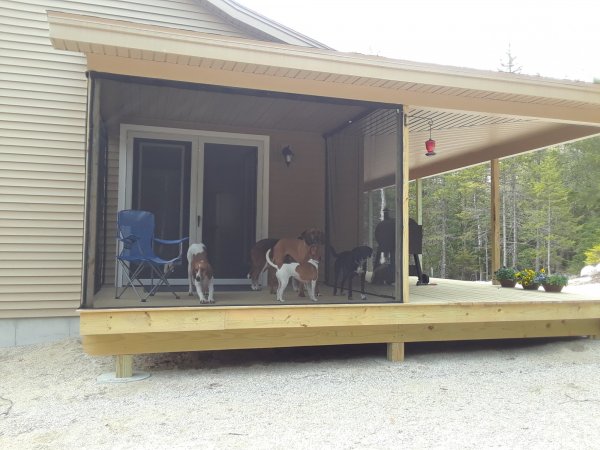

    We screened in a corner of our porch last year. I went with curtains instead of screens on frames because our porch doesn't have railings and I dont want the screens up all year and have to deal with a place to store them.

    Very nice. Great spot for the dogs to relax.
    Our plan is like what basod has going on with a gable roof out. Ours will be two steps down to grade level with a flat river stone patio. We used the screen tight system at the last house with stainless screws holding the tracks and it worked great. We will save coin by not needing railings too.
