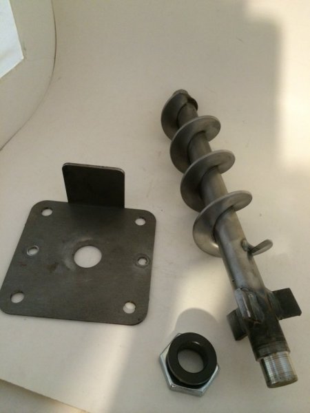

    After beefing up a Breckwell it is time to Supe up a Saranac with Nylatron!
    The West Point and the Saranac have the same auger and the same old tired and gunked up brass bearing!
    Sure you can clean the brass bearing and soak it in light machine oil once a year to keep it up to snuff, but if you don't and the pellets may jam and the auger motor can crap out! If the same auger motor on a Whitfield lasts 15 years then why not this?
    Many of the older Whitfields have an upgraded Nylatron auger bearing. I have seen these bearings on 15 - 19 year old Whits with the original auger motor!
    Ok, so why not a HRWP or Saranac? If you drill two holes in the aftermarket EndPlate with the Nylatron Bearing it fits! Now the auger turns as smooth as silk!

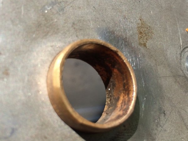

    Pic 1 - Brass bearing is nasty and gummy after 3 or 4 years! Who needs it?

    Pic 3 - Auger, Orig EndPlate and Nylatron Bearing. Nylatron Bearing is too big for Orig End Plate.
    Orig EndPlate could be reamed out, but would need a machine shop.

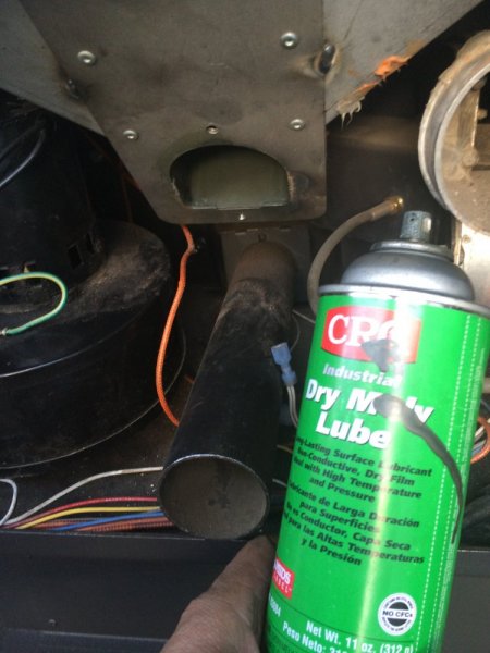

    Pic 8 - Dry Moly!

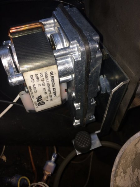

    Pic 10 - New Hi Performance Gleason Avery motor and new Nylatron bearing and enplate installed!

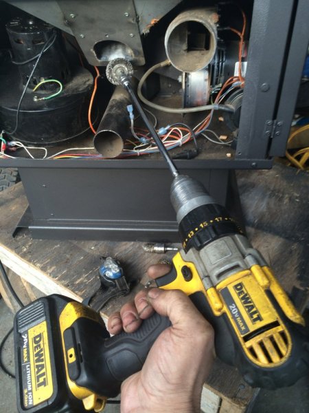

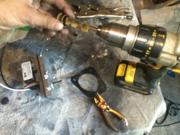

    Pic 11 - Orig Auger polished with wire brush on drill driver to remove carbon. Pimples of slag(Auger Pox) ground down and auger coated with high temp "Dry Moly" spray!

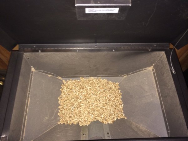

    Thanks Smoke, I checked everything for fit before I started drilling. I just put the test cord on the auger motor and it turns nice and smooth! I will try a test fire as soon as I get a chance.

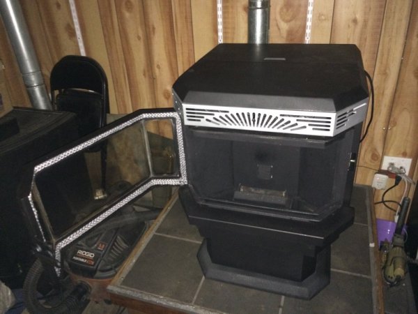

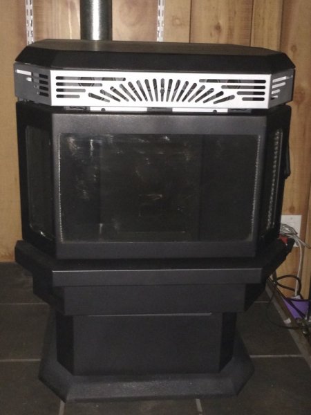

    The results are in and the pellet feeding is much more consistant. Not choppy like with the old gummed up brass bearing.
    Also to get the value in, I had to sand the gold on the fire door out! LOL

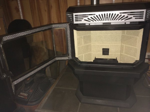

    The new fire brick backing just came in. :)
    The new paint makes it a winner!

    What size door gasket is that?

    Hi Dexter
    The door gasket is 7/8". It is a biggie! ! ! LOL

    That's what it looked like. Same size as the Quadrafire Classic Bay 1200. :)

    Yes, that makes it cost more! LOL
