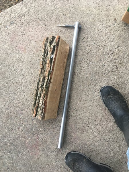

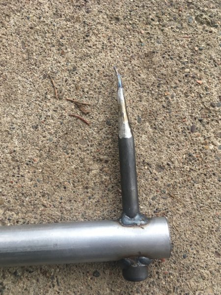

    Well I'm a cheap SOB and decided to make one at work to see if I'd actually use one first before I bought one (I had to pay $1 for scrap and get one of the guys to weld the bolt on for me). It's 32", I can cut it down if needed. I only messed around with some already split stuff off the stack. Seems pretty handy. I'm waiting for my orange paint and athletic tape to make a less slick handle.

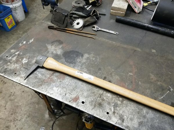

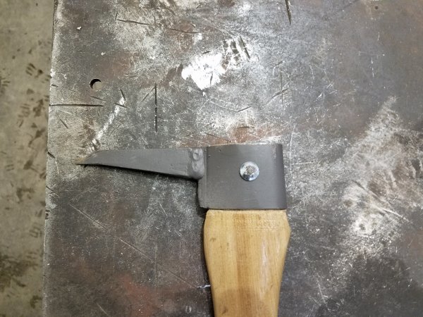

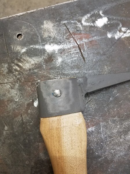

    Just recently found another pickaroon head. I sand blasted the rust off and mounted it on a pole axe handle that the I had laying around. I didn't have a roll pin handy for the keeper hole in the head so I used a carriage bolt and peened the end over. This is about 10" longer than my other pickaroons and will be used to pull wood out of the trailer or pickup. This style head is excellent for all around use. Once you start using one to manipulate rounds and splits you will feel lost without it! pickaroon1.jpg pickaroon2.jpg

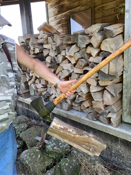

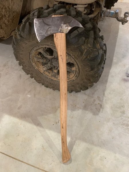

    Here's one I made out of a broken Kelly True Temper Perfect double bit ax. It's probably not the best Hookaroon maybe more of a Pickaroon but I really like it, and almost always have it in one hand when loading firewood. I never go to the woods without it. And I really like having the ax bit available to me on the other side. Very useful. I later shoehorned a curved single bit ax handle into it with the curve to the Pickaroon side. It's a little easier to pull with it that way, but I can't find a picture of it, at the moment with the new handle in it. Wait a minute, that first picture does show the singlebit handle in it after all.
