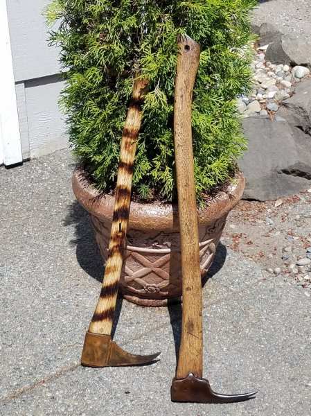

    I would rather not cut at all than leave my pickaroon behind! I currently have 3 pickaroons.The one with the tiger stripe handle I made completely myself. It is OK but my least favorite. It stays at the woodshed to hook out splits to wheelbarrow to the house. The one on the right I made from a boys axe head. The slightly curved beak works well for general manipulation of rounds and splits but not as good for hooking rounds or splits from the trailer toward you. The one with straight beak but the most hook at the end is my favorite. Who ever made this got it right. It is good at everything but excels at reaching into the trailer and hooking out rounds or splits. If you use a pickaroon for carrying rounds or splits, a shorter handle would be best (or get tongs). General use, about 36"to 38". Longer handles for those reaches to the back of the truck bed. This is just my experience, your mileage may vary. I just can't bring myself to buy an expensive Stihl or brand name pickaroon but many swear by them. Wood handled ones seem to turn up at garage sales fairly often for cheap. Hope you find one that fits you soon!
