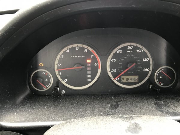

    Hello

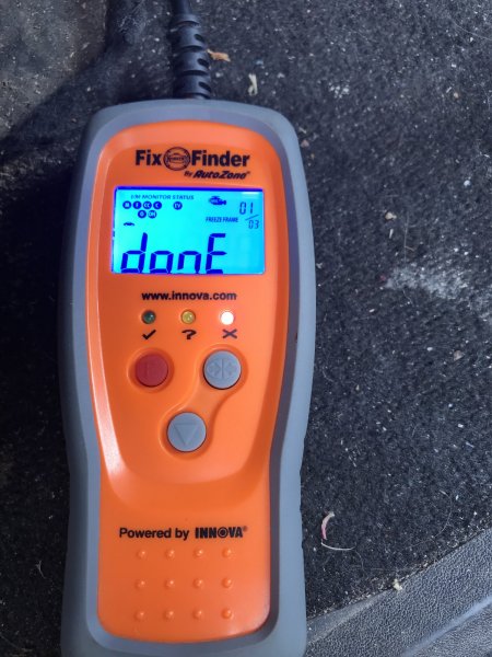

    The Check engine light comes on after being reset. Then after the 38 mile drive of 15 street and 15 highway to activate the 8 emission sensors in the computer, Another 8 miles after the Check engine light came on and 2 codes popped from the AutoZone Free Checker.
    P0420 - Catalyst System Efficiency Below Threshold B1
    P1457 - Evaporator Control System Leakage (Evap Canister Area)
    Looks like it maybe as simple as a Evaporator Canister or Hose or a very expensive Catalytic Converter??
    Anyone have this problem and a what needed to be fixed?

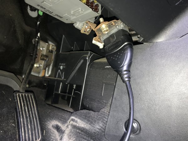

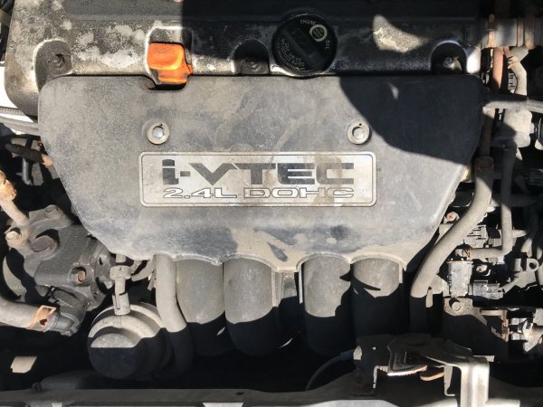

    1-2 - AutoZone Check Engine Light Analysis
    3. Check engine light on in dash on far left.
    4. - Honda Car Engine
    5-7. Checking the computer codes with AutoZone Self-Check Analyzer
    Car Code Dump Procedure with AutoZone Self-Check Analyzer
    1. Pug in Analyzer
    2. Start Car
    3. Wait until analyzer display reads "done"
    4. Turn car off
    5. Unplug analyzer
    Bring back in store and get printout of the code dump with list of parts causing the problem. :)
