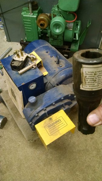

    Winco's have a straight shaft and use an adapter. 3600 (2 pole) is the generator rpm. Frequency x 120 รท no. of poles= synchronous rpm.

  8. LodgedTree

    Thanks ScrewLoose; what you show in your picture is EXACTLY what I have. Mine says "Burden" on the electrical box cover, but it must have originated from Winco.
    Any idea on where a person can find an adapter? Any tractor dealership or do you think it is a Winco Only part?

    Well I am cheap so I bought a commonly available 1" bore adapter from surplus center and bored it out to the uncommon 1.125 dia. To fit. Maybe eBay ? As a side note take the sheet metal cover off the end of the generator and make sure that the brushes move freely in the holders and the comutator and slip rings corrosion free. Rock solid machine, much better and more reliable than the "brushless" ie "cheap" stuff sold today.

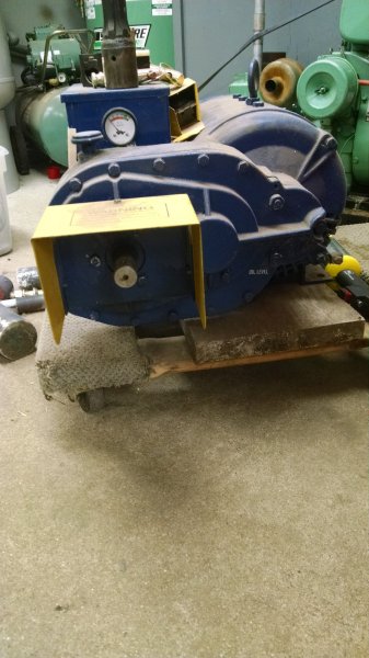

    fuelrod, LinkedXJ and concretegrazer like this.

    When WinCo supplied the unit on a trailer the PTO shaft was keyed and pinned on. My plan is to make a 3 point mount so I removed it from the trailer. I still have the shaft and the trailer for that matter. Not sure what shipping would be to you but your welcome to it if it helps. It's a rather long telescoping one with guards. I don't remember any issues with it. 1 3/8" -6 spline.

    Thanks for letting me know how to get and make the adapter. I am a machinist/welder by trade so I can do that as well. I am retired now, but still remember how I think! I got a Supply Center catalog here too, and know them well.
    I have tried to take the cover off, but sadly the bolts are rusted quite tight. I can get them off eventually, it was just 10 degrees yesterday with a pretty good snowstorm brewing so I figured I would battle it on another day. That was a poor plan; the power went out again today; 3rd time in 3 weeks for extended intervals. Drat!
