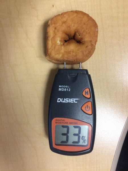

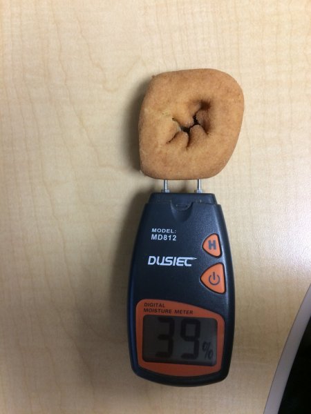

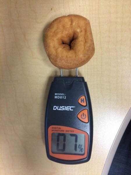

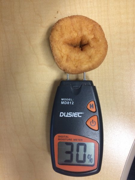

    One of the current projects I have at work is redesigning packaging for donuts to address "dried out" customer comments. Being an engineer, I want a quantitative method to determine dried out vs good donuts, but our food technologists group has insisted the only test is a qualitative method: feel and eat the donuts to determine what's good and what's bad at the end of shelf life.
    That wasn't good enough for me since personal tastes are a little different. I tried weighing them to determine if weight loss was a factor but that's given me inconclusive results, and then it hit me that I've got a moisture meter at home that just might tell me what I need to know. Turns out it works great!
    It seems the sweet spot is somewhere between 33% and 40%, my next step is to determine what's the cut-off point: what percentage is acceptable, what is marginal, and what is unacceptable so I can then create a specification around moisture and design the packaging to meet that.
    So I do have a question. I see moisture meters ranging from my $20 cheapo to $200 dollar units. Does anyone have those much more expensive ones, and are they that much more accurate? I get to buy one on the company's dime and I need to know that it'll be very accurate in the 30-40% moisture range.
    Any recommendations?
