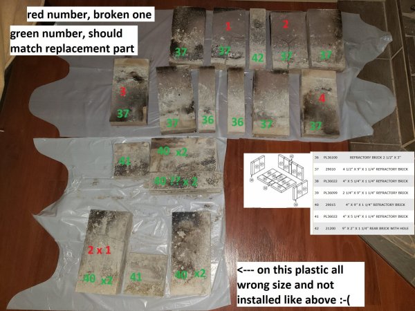

    I have to replace a few bricks in my stove and it look like my stove recommend normal refractory brick
    but i see that I can get high density one too (not sure if it's recommended for my stove)
    what are the difference between the two? does it matter which one i pick?
    is there a way for me to tell what brick i currently have? the stove was installed by previous owner so maybe i already have high density?

    picture worth a thousand words :cool:
    I removed all the brick to inspect them and i have 6 broken brick and the whole "floor" are using wrong sized brick, previous owner really did something here...
    floor one (#40) are 4 x 8 instead of 4 x 9 and small one(#41) are 4 x 4 instead of 4 x 5.25

    At the temps in a typical wood stove, high density firebricks aren’t really necessary. High density bricks are indicated in places like high temp forge linings and some high temp rocket stove heater applications, but not for wood stoves. Save your money and get normal refractory brick. Insulating fire brick won’t hold up to the abuse inside a wood stove but isn’t necessary anyhow.
    If you need to cut some of them, a diamond wheel on an angle grinder works fine. It doesn’t hurt to keep some water on the cut to keep down dust and temps.
    And use a big masonry bit for that one hole.

    I went to my local store they had only one kind (no idea if they are high density or not but they are "heavy") / size (4.5 x 9 x 1.25), 4$ per brick now it's time to cut and replace the one that need to be replaced and fix the way the floor was installed.
    thanks to everyone for your feedback!
