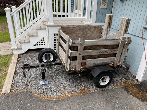

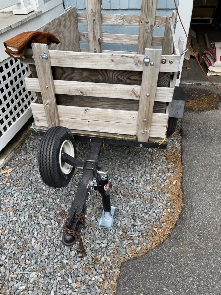

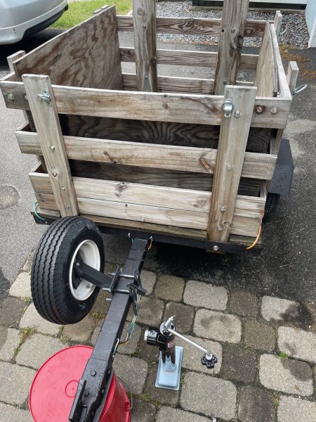

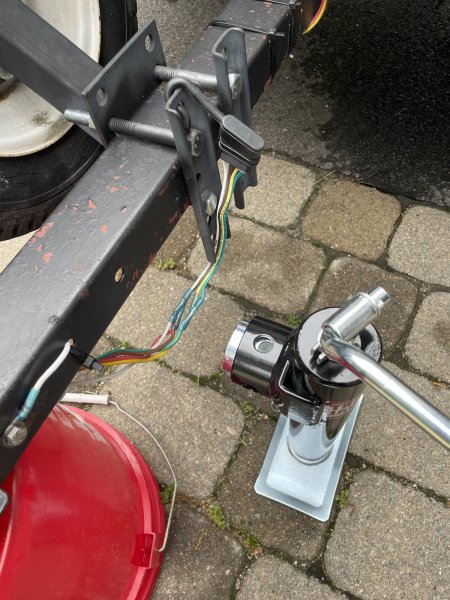

    I have seen instructions for an item say you must glue it or tape it together but have you ever seen instructions that say you must weld it??? LOL
    Just got a heavy duty Harbor Freight jack for my trailer. Good welds are rated to hold 40,000 up to 80,000 lbs per inch.
    It states on the box
    "Comes with Assembly Hardware"
    I found no pic of assembly and no mounting bracket"
    In step 3 of the instruction manual in small print it states:

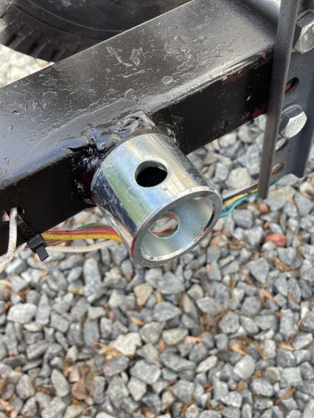

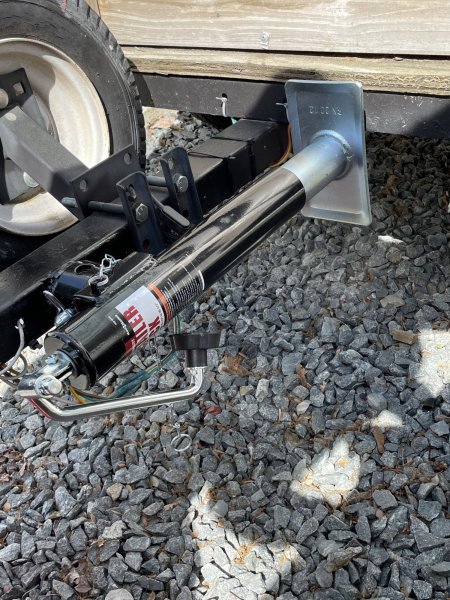

    Position in place and weld on! LOL So instead of returning it, I did it! LOL

    Not many DYI assembly projects start with the word "weld". Good think you had the know-how and equipment!

    Your weld has to be a heck of a lot stronger than the crappy bolts it would have been in the box if it was a bolt on kit.
    Nice job and the end result is much better.

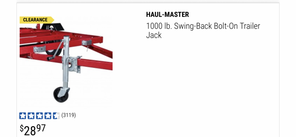

    The one with the bracket went on sale over the Memorial Day weekend for $18.97 naturally after I already purchased the weld on. So I would have to return it and then drive 1/2 hour to another store which had one in stock and then end up with a trailer jack that supports 1,000 lbs instead of the nice heavy duty one I got that supports 2,000 lbs with a better flat base that does not make a divot in the ground.

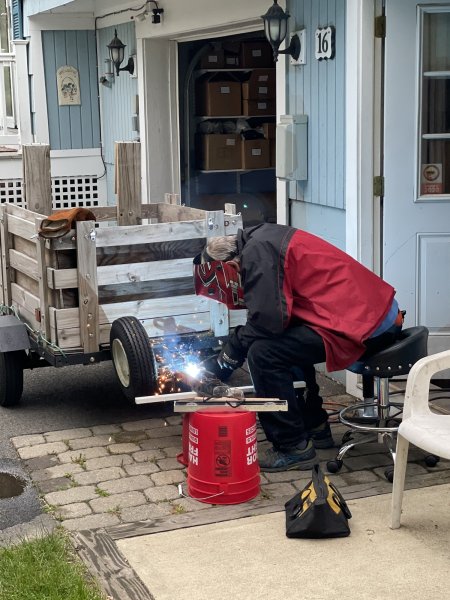

    So I decided to pull out the welder. :)
    Cheaper trailer jack with bracket
    1000 lb. Swing-Back Bolt-On Trailer Jack

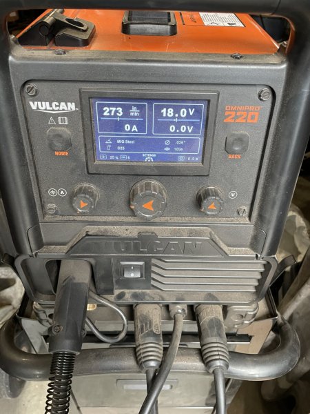

    I do have a stinger and would need either 6011 or 7018 rods would be good.
    What is a good rod to use for this???
    Consensus is 7018 rod

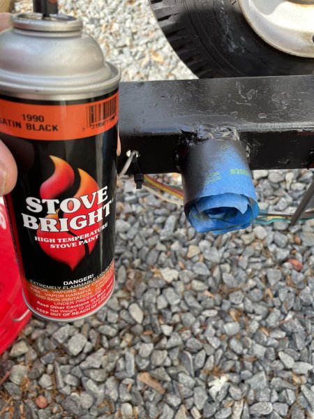

    After the welding and grinding, It is not done until the masking, primer and paint touch up is complete!

    X2 on the 7018

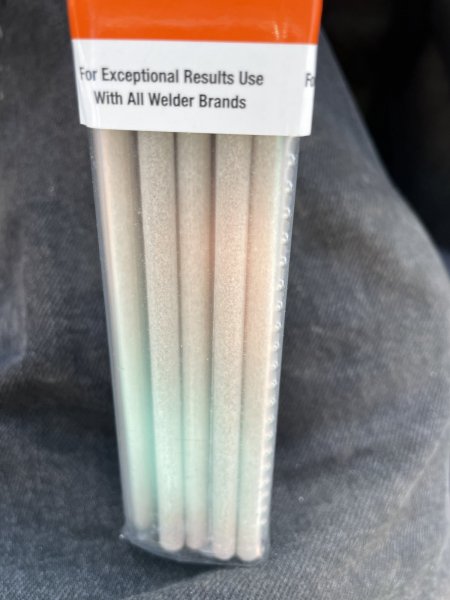

    Father’s Day 20% coupon, so now is the time!
    E7018 1/8” diameter :)

    Yes, since it is old and a little rust, I thought the 7018 would be a little better.

    6011 will be more tolerant of a not so clean base metal. 6011 is a fast freeze rod and isn't as forgiving of bad technique, in place of 7018ac I would use 6013 unless I had a dc machine. You can almost drag 6013.

    Depending how much you plan to lay in
    6010 root. Better penetration
    7018 hot pass(es)
