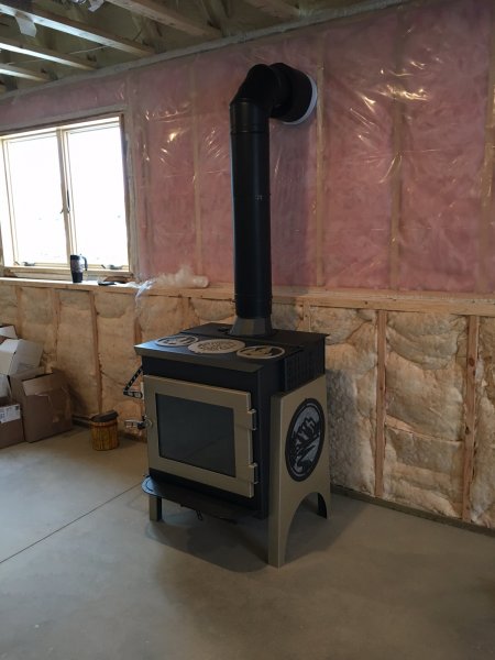

    After 6 long months in the making, Our builder gave me the go ahead! Nothing fancy yet, but it is in and ready to heat in the neighborhood of 2800 sq ft. Basement is unfinished, but framed up for sheetrock. I will start the process once I move in.

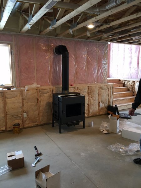

    Stripped down and moved into place:

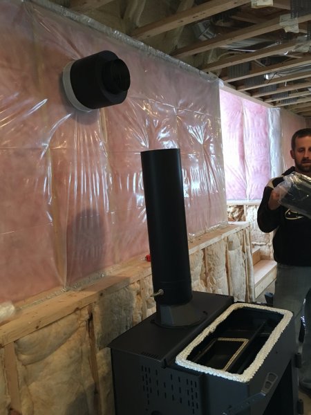

    Installed a damper and adding the double wall up to the thimble:
    Got it connected:
    (Note the walk up on the right which is going to be perfect for bringing in wood!)
    All back together and begging to be lit: IMG_3830.JPG
    Man I can't wait to start a fire in it!! We hopefully close by the end of next week or the following week! I will also probably add some sheetrock behind it to tidy up and keep the insulation from being exposed right near the stove.

    Is the stove far enough away from the wall? (Hadda ask)

    The stove is 8" from the wall to allow for durarock and some stone veneer in the future. Can be 6" with the close clearance shield I got from WS.

    I have metal studs and concrete behind mine so I could technically hug it to the wall. I have a six inch gap behind the heat shield and the stone stays cool behind the stove. It barely gets warm behind the stovepipe.
  14. Babaganoosh
    Babaganoosh
    Sep 7, 2015
    1,137
    3,827
    Jersey Shore
    You are running double wall pipe I hope? I forget the clearance with double wall pipe but 6 inches to the wall is awesome for the stove. I've got a corner install in my den and I'm thinking of moving it to the living room which is more centrally located. A corner install takes up more room than you think and it doesn't allow you to put a rack of wood next to it. Obviously outside of the clearance to combustible range that is.
    Backwoods Savage and yooperdave like this.
  15. Sconnie Burner
    Sconnie Burner
    Feb 23, 2015
    617
    2,856
    Western Wisconsin
    Double wall has a 6" ctc as well. Having it 6" from the wall definitely saves a lot of room vs 14" or 16" out!!
  16. Unhdsm
    Unhdsm
    Jan 30, 2014
    472
    1,429
    Bradford, Vermont
    Yes, it's double wall.- although with nothing combustable behind it, I might have been able to go even closer. I needed 6 inches for the 90degree bend. I had it corner installed at the last house and the back wall seemed to get much warmer. Maybe because it was dark slate tile.
