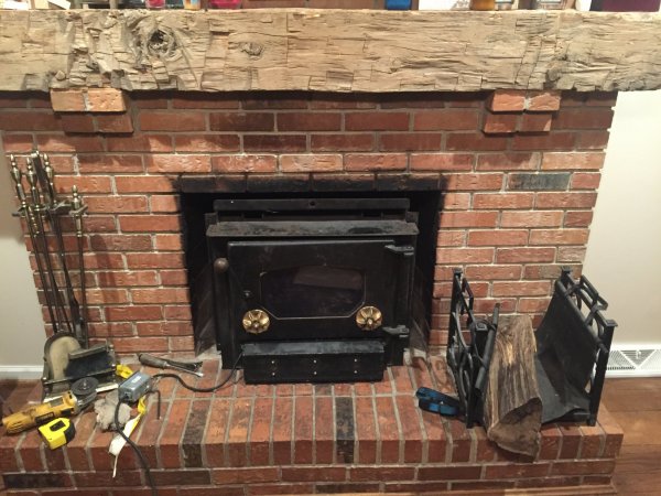

    hey guys! New to the forum. My wife and i just bought a house and installed an old fireplace insert. I can’t find any name or numbers on the stove. Any help?
    I’m looking to replace the blower on it. It’s very noisy
    Thanks

    Welcome to the club, fordguy64! I'm not 100% sure what model of insert you have there, but I gotta say that's a beautiful hearth!
    I'm betting there's a tag on the back of the stove, have you removed the blower yet? Might even be a tag on the blower or inside where the blow connects......

    Maybe take the blower apart clean it and oil it , and welcome to the club

    likely have to replace bearings on blower ( they could be bronze oil lite sleeves). the heat over time cooks everything dry
