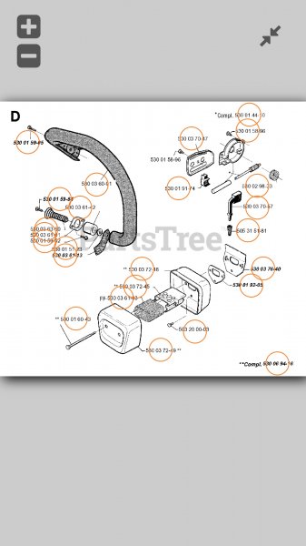

    I’ve got it inside today and I’d like to peak at the piston through the muffler. I’m embarrassed to say I can’t get the muffler off .
    I looked at replacement mufflers online and it looks like I need to take the outside of my muffler off to get to a smaller 3d screw on the inside. Anyone got any tricks? Am I missing something obvious? [​IMG]

    The front cover should come off, then you can access the rest. A screwdriver is all I have ever used.

    The front half of the muffler just needs a little persuasion. A small mallet against the sides, alternating if need be, should loosen it up. Work it gently, don't force it.
    The issue sounds like a fuel restriction. New filter and fuel lines may be all it needs. The carb can be rebuilt instead of replaced, usually very easily. The screen the illustration above shows inside the muffler also likely needs to be cleaned. They get caked up with soot/carbon & rust. A wire brush and a plumbers torch usually makes short work of it.
