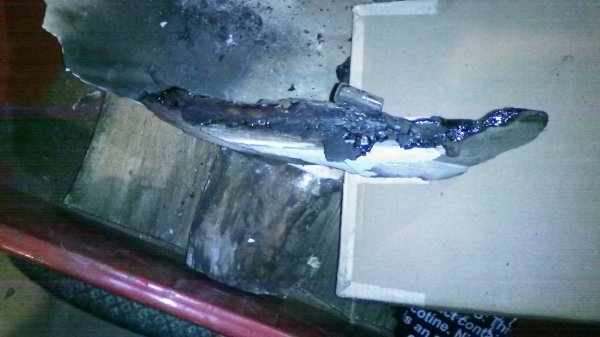

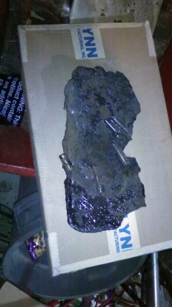

    Soto eater and elbows,, Make real sure that each snap joint is properly in place- I lost 4 rods up my flue on the off side of the off set. I had just the rod set up the flue with out the wacker end on it. Prior there seemed to be something impeding the passage of the head- hence rods only, did not count the # of rods when I pulled it back out. fast forward and a couple fires later I hear what sounds like creosote dripping. and a bit later sounds like stones rattling down. Attacked things a couple days later when everything gone out - hmpph insulation boards do not want to come out ( nc30) well those 4 rods up the flue melted and welded the insulation boards together as well as lightly anchoring them to the back of the burn chamber. Insulation boards removed in several pieces. trip to local kiln builder/repair place for a piece of KO wool type H board. back in business. also have to get another soot eater for more rods as my flue is also apx 30+ feet. Must have been one section that the lock wasn't seated properly. Whole reason for this event was draft seem to real lazy- this back when it was still fairy cool out with lows in the 20's at night. Oh, and the clunking was the rod ends falling down. Those rods will burn when liquefied at apx 1100 degs.F as I was getting some weird little flames at the reburn tubes at the joint between the 2 boards ( reason for thinking creosote) burned a bout a cord of dead standing ASH this winter that I got in early Fall. So figured it wasn't quite dry enough. Marginal at apx. 20% on el-cheapo meter. yes fresh face after being in house for a day. Could kinda feel moisture when slicing it open on Band saw. My Challange this past season was everything was pretty soaked from driving rain and then freezing - stacking several cords in basement helped some but not a lot. If I remember I will snap a pic of the mess.

    pics of the melted cleaning rods - you can see the connectors in the mess as well - at least one set still coupled

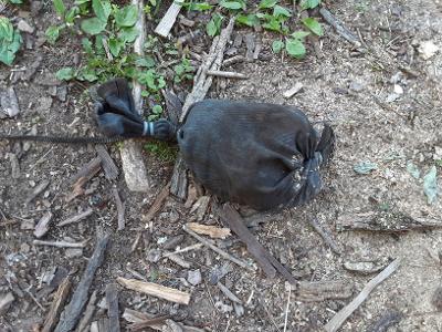

    I take an old pair of jeans, cut one of the legs off, fill it with golf balls or something else smooth but heavy, wire tie the ends, attach rope to one end and drop it down the pipe. Pull it up and down a few times and the chimney is clean. This is done from the roof but I do both of my chimneys like this every year.

    Here is a picture of my golf ball blue jean cleaning device Chimney Cleaner.jpg
