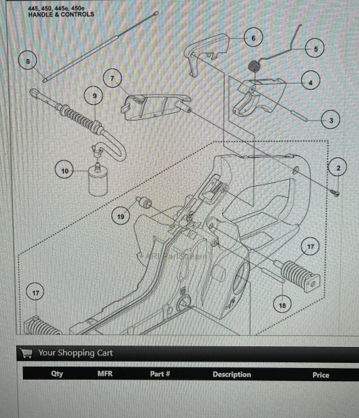

    tank vent vs fuel cap??? fuel cap has a pop up tab that allows you to open and close the fuel port..not really seeing a vent on that, but probably the two little tiny holes on the side...I can blow that out with the compressor...is there another vent under the cover I should be looking at/for??? I am looking in the owners manual and not seeing anything on the schematic, but I could very well be missing something here. Thank you!

  9. The Wood Wolverine
    17,938
    113,947
    #19 is the tank vent.
    Try cutting and opening the cap first, like mentioned.
