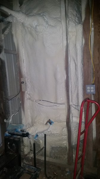

    Yeah batch burning is a great way to go, if you have the ability to store the heat. I know a guy that installed a pair of 1000-gallon used propane tanks in his basement, built a room around them and then filled the space with spray foam. It would hold heat for days. He was using a Tarm indoor wood boiler and was only burning a load of wood two or three times a week. Only downside is having to start a new fire every time. Which really isn't a big deal if you're somewhat of a pyromaniac anyway.
