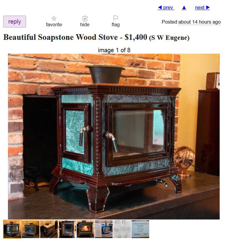

    Hey guys, I haven't posted in a while but I just got a new place with this Hearthstone stove and about 5.5 cord. We are using it for supplemental heat to bring the electric bill down. I think it is EPA with no cat - I have a picture below to help ID it. Do any of you know which model it is or have any pointers on operating it efficiently? Trying to get the most BTUs I can out of it. Thanks, as always I appreciate your advice!

    I’m guessing a Manchester; I’m guessing it’s about 2.4 cubic foot fire box.

    Too small to ge a Manchester and those have duck feet. That looks like a heritage. I pushed 30 cords through one. It’s just over 2 cubic feet and the side door is much nicer to use than the front.
    redline on that stove is 550 stovetop. Maybe it’s 600 but I always stayed under 550 for a margin of safety. Pretty cool, not like a steel stove at 800.
    mine worked great and looked great. Not very efficient, not durable, and slow to warm up but it looks great and delivered the heat.

    Advice? Yes. That manual states the top can go to 600 degrees, so go ahead and push it full of wood and control the burn using the air controls rather than the amount of wood - provided all your seals are good. Use thermometer, don't guess!
    In my opinion that is the prettiest stove ever made, a Hearthstone Heritage. Here's one just listed near me.
    It is only rated at 55,000 BTU's, thus the O/P's probable issue, but with all the features I think it's a great stove. Wish I needed it!
