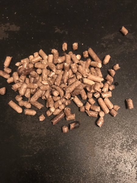

    Edit: What kind of pellets are you burning, just curious.

    It’s getting warm but not like really hot. I made sure when I cleaned it I took the cover off and stuck a crevasse tool in there to suck everything out. I have always had a problem after I clean it it won’t ignite. But it’s taking a while to start. I’m using FSU pellets now but I have stove chows and blazers too. Only thing I can think of is maybe the back where the wires come through for the igniter the grommet isn’t siliconed but it never has been. My stove was made in 2012 but I don’t get why I keep having problems igniting?

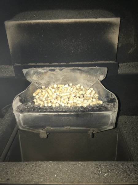

    Should be lit by now

    Some of them look like they wanted to ignite but didn’t.

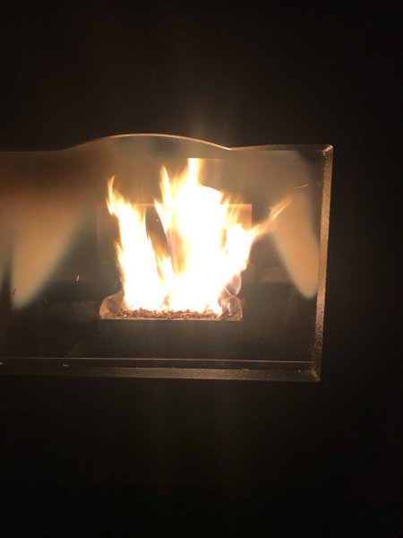

    Once i light it it’s good. But as you can see the black on the glass, I just cleaned it Sunday afternoon

  9. PelletHound
    PelletHound
    Oct 4, 2014
    874
    5,258
    SE Ma.
    Your firebrick is very sooty.Looks like a dirty burn is going on.I would check for airflow issues first.

    Upstate, ny
    Also it could be because some times I don’t take pellets out before I light it so I have a big rolling flame. Rolls over the heat exchangers and rolls onto the glass
