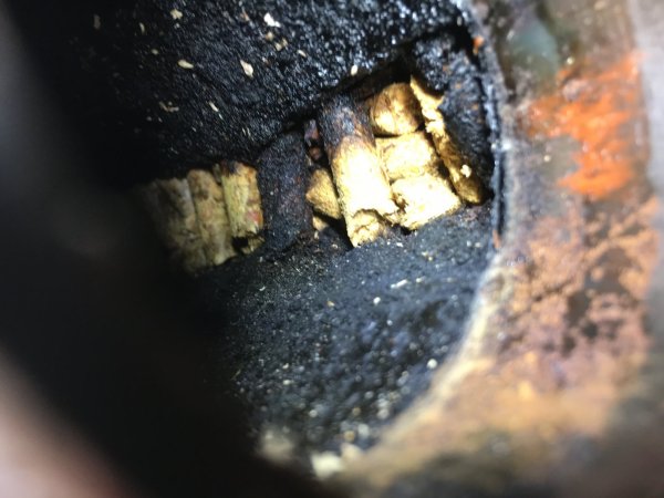

    Well here is the update, i think the photos will say it all. It took a lot of cleaning but the air bypass is in and a new auger and many hours of scrapping spraying and making some home made tools to complete the job. You where right Bob a lot of hours and no it wasn't easy. Thx again for you advice IMG_2680.JPG IMG_2669.JPG IMG_2670.JPG IMG_2673.JPG

  14. ivanhoe
    ivanhoe
    Oct 18, 2013
    2,979
    11,867
    Northern Ontario
    That was way overdue, glad you took the time to troubleshoot it:D

  17. badbob
    badbob
    Apr 23, 2014
    2,482
    9,945
    Nice pics.That was very bad.I think you will also find less carbon buildup in the burn pot,with the air bypass.Also,if you have the original control board,the latest board,in my experience,burns cleaner,but a little more heat loss from the stove.

  20. Lousyweather
    Lousyweather
    Dec 23, 2013
    2,798
    9,040
    After you pulled the auger, did you look inside the feeder (yea, I know, tough to to), and ensure that the gumminess was cleaned out of the inside as well? What ends up happening is that the gum forms a matrix inside the feeder of gum and unburned pellets....then pellets falling from the end of the slide plate and onto the auger are impeded by the mess inside the feeder. You might have done this, I just don't know. Its a pain to get the stuff out!
