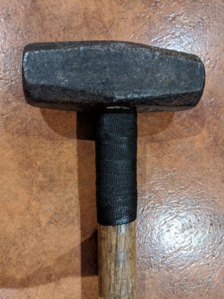

    I found some at Lowe's for $6.99 a box. IMG_20200109_8731.jpg It was in the plumbing repair section. Very easy to use, as you said. I did my sledge handle, which had some splinters right below the sledge head. IMG_20200109_44397.jpg
    There was only enough material to wrap one tool. But the package said that once you open the sealed pouch, you have to use it right away.
    I really like how it came out, I think I'll get some more, for a few other handles.

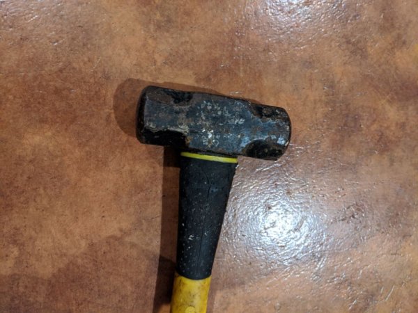

    This is my favorite type of sledge. I don't like the modern ones that have this shape: IMG_20200109_51688.jpg
    They are lighter than the old-style 8 pound ones, and the strike surface is convex, so the impact feels sloppy.
